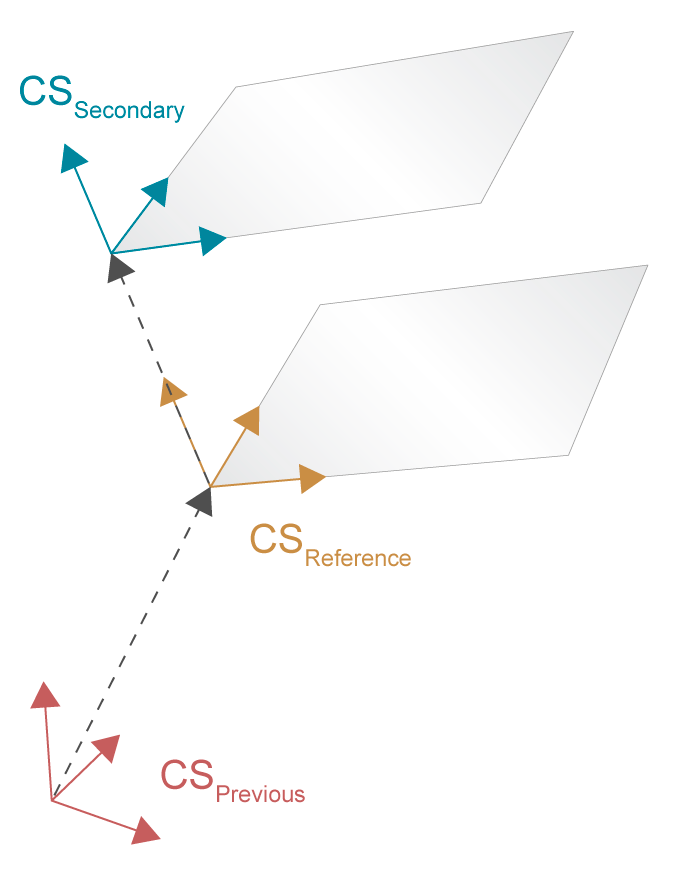

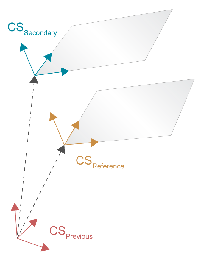

Selection of reference coordinate system (P-CHAN-00396)
P-CHAN-00396
Select the reference coordinate system to define the coordinate system of the second path
If this parameter is initialised with 0, the secondary coordinate system is defined based on the previous reference coordinate system.
If this parameter is initialised with 1, the coordinate system of the second path is defined based on the reference coordinate system.

Selection of reference coordinate system (P-CHAN-00396) 1:
CS of path 2 is based on basic CS of path 1 (2nd_path_on_actual_1st_path = 0)
Selection of reference coordinate system (P-CHAN-00396) 2:
CS of path 2 refers to CS of path 1 (2nd_path_on_actual_1st_path = 1)
