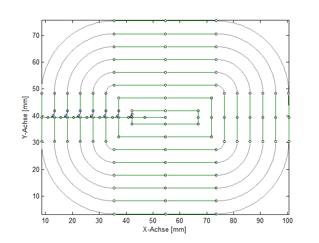

Example: Pocket milling cycle with polynomial contouring

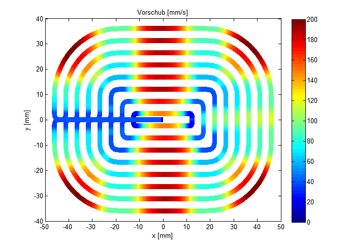

Feed along the contour with opt_contour_mode=0:

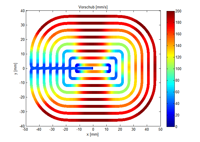

Feed along the contour with opt_contour_mode=1
?In this example, the reduction in machining time is 18%.
