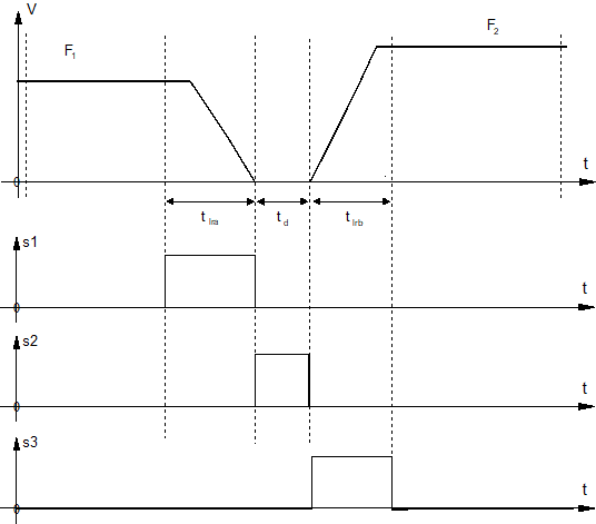

Switching feed rate adjustment (P-CHAN-00300) 1:
Timing diagram of s1..s3 signals when P-CHAN-00300 = 1

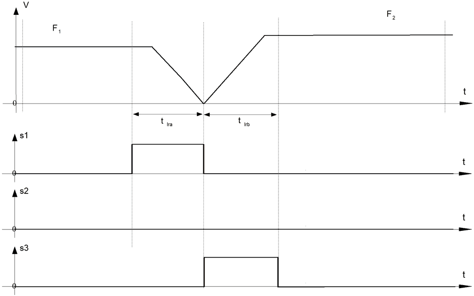

Switching feed rate adjustment (P-CHAN-00300) 2:
Timing diagram of s1..s3 signals when P-CHAN-00300 = 2
