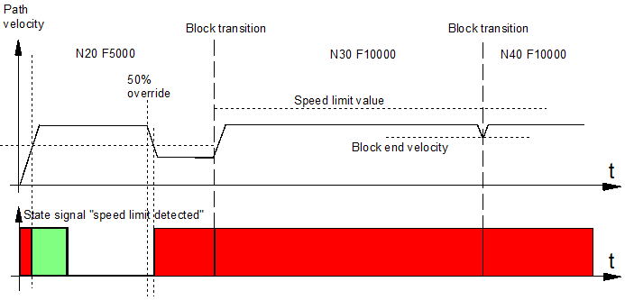

Weighting the speed limit via override (P-CHAN-00155) 1:
Timing diagram without override weighting (f_override_weight_v_limit = 0)

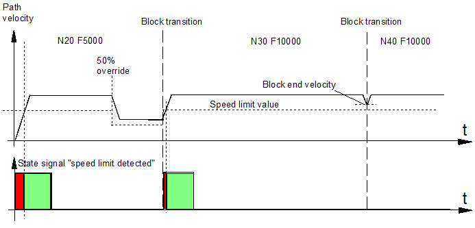

Weighting the speed limit via override (P-CHAN-00155) 2:
Timing diagram with override weighting (f_override_weight_v_limit = 1)
