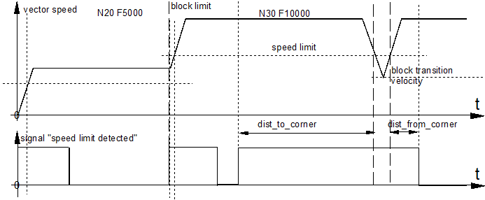

Depending on the machining technology used, it may be necessary for the controller to inform the PLC about changes in velocity profile. In this case, if velocity falls below the speed limit, the CNC generates a signal 'speed limit detected' (SLD).
Look ahead speed limit (speed_limit_look_ahead.*) 1:
Timing example of speed limit look ahead
speed_limit_look_ahead.enable                   1 0: inactive, 1: active
speed_limit_look_ahead.v_limit 750 [0.1%] of programmed speed
speed_limit_look_ahead.time 1 unit of time or distance
speed_limit_look_ahead.dist_to_corner 5000 [0.1 µm or µs]
speed_limit_look_ahead.dist_from_corner 6000 [0.1 µm or µs]
speed_limit_look_ahead.override_weight_v_limit  0 0: inactive, 1: active
