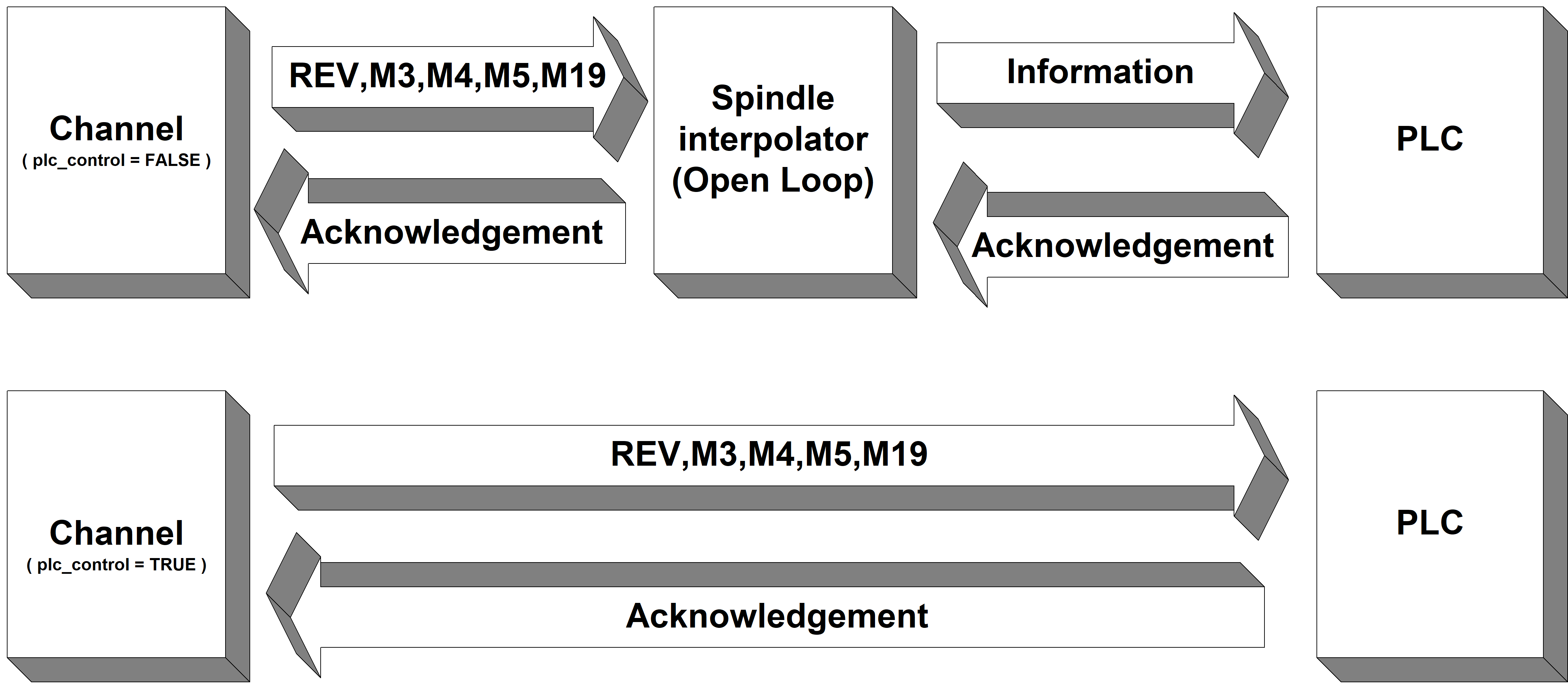

Spindle control by PLC via channel specific interface
This parameter is set to TRUE if a spindle is controlled directly by the PLC and not by a spindle interpolator in the NC channel. Note here that all synchronisations are no longer (spindle) axis-specific but are output and processed by the channel-specific HLI range. The axis-specific syntax for programming spindle commands is still allowed, but is limited to specifying the speed and the M functions M3/M4/M5/M19.

Channel-specific PLC spindle (P-CHAN-00069) 1:
Difference between spindle control by spindle interpolator or PLC
