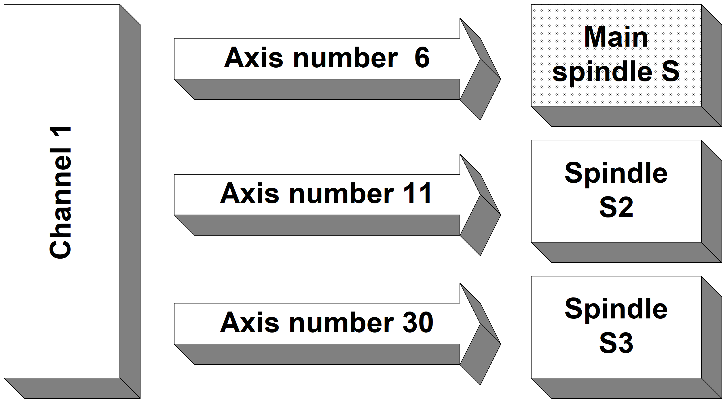

Parameterisation example: Configuration of a 1-channel system with 3 spindles. After start-up, spindle 'S1' with logical axis number 6 is the main spindle. It is addressed by the spindle name 'S'. The spindles with logical axis numbers 11 and 30 are programmed by their default names 'S2' and 'S3'.
spdl_anzahl                          3
main_spindle_ax_nr                   6-> -> ->-
main_spindle_name                    S ->-       /
spindel[0].bezeichnung               S1-<-       /
spindel[0].log_achs_nr               6-< -< -<-
spindel[1].bezeichnung               S2
spindel[1].log_achs_nr               11
spindel[2].bezeichnung               S3
spindel[2].log_achs_nr               30
* Note: The default value of variables is a blank string.
Spindle name (P-CHAN-00007) 1:
Example of channel-specific spindle configuration
