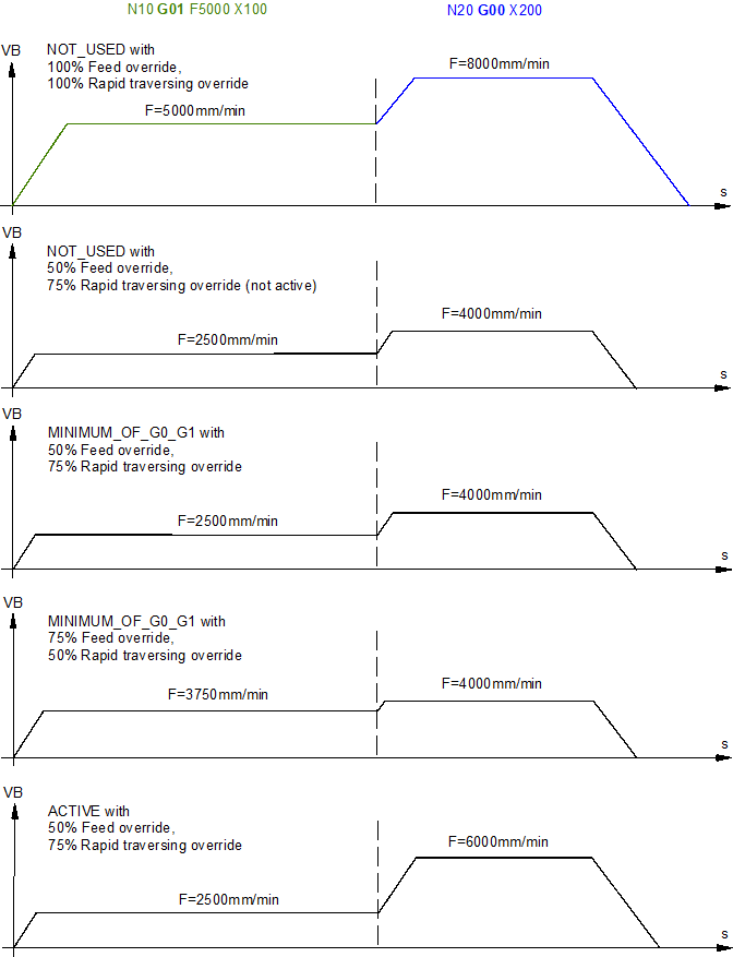

NOT_USED or 0:
Rapid traverse override is inactive. Rapid traverse override acts on feed and rapid traverse blocks.
MINIMUM_OF_G0_G1 or 1:
Rapid traverse override is active. Feed override acts on feed blocks; the minimum of feed and rapid traverse override acts on rapid traverse blocks.
ACTIVE or 2:
Rapid traverse override is active. Feed override acts on feed blocks; only rapid traverse override acts on rapid traverse blocks.
ACTIVE_EXTENDED or 3:
Same as under ACTIVE, rapid traverse override also acts exclusively on homing G74, measurement G100 and manual mode controlled by the CNC.

The channel parameter acts on the channel-specific override interface.
Please note in ACTIVE and ACTIVE_EXTENDED modes that G0 movements can only be influenced by the rapid traverse override.
Rapid traverse override (P-CHAN-00181) 1:
Examples of rapid traverse override modes
