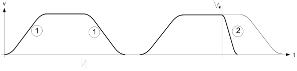

Remarks | Parameterisation example: meas_use_std_dynamic 1 The effective dynamics dependent on the parameters P-CHAN-00097 and P-CHAN-00214 are shown in the table below. |
Dynamics for measurement travel with non-linear slops
Active dynamic for measurement run | Active delay with measuring signal | Valid deceleration ramp at FEEDHOLD | Profile dynamic (1) (limiting algorithm) measurement signal inactive | Deceleration ramp (2) (limiting algorithm) measurement signal active |
0 | 0 | 0 | Acceleration in rapid traverse P-AXIS-00004 | Acceleration in rapid traverse P-AXIS-00004 |
0 | 0 | 1 | Acceleration in rapid traverse P-AXIS-00004 | Deceleration at feedhold P-AXIS-00053 |
0 | 1 | X | Acceleration in rapid traverse P-AXIS-00004 | Acceleration in rapid traverse P-AXIS-00004 |
1 | X | X | Acceleration at machining P-AXIS-00001 or delay at machining | Deceleration at feedhold P-AXIS-00053 |
Active dynamic for measurement run | Active delay with measuring signal | Valid deceleration ramp at FEEDHOLD | Profile dynamic (1) | Deceleration ramp (2) measurement signal active |
0 | 0 | 0 | Acceleration in rapid traverse P-AXIS-00005/ P-AXIS-00006 or delay at machining P-AXIS-00280/ P-AXIS-00281 | Acceleration in rapid traverse P-AXIS-00005/ P-AXIS-00006 or delay at machining P-AXIS-00280/ P-AXIS-00281 |
0 | 0 | 1 | Acceleration in rapid traverse P-AXIS-00005/ P-AXIS-00006 or delay at machining P-AXIS-00280/ P-AXIS-00281 | Deceleration at feedhold P-AXIS-00024 |
0 | 1 | X | Acceleration in rapid traverse P-AXIS-00005/ P-AXIS-00006 or delay at machining P-AXIS-00280/ P-AXIS-00281 | Acceleration in rapid traverse P-AXIS-00004 |
1 | X | X | Acceleration at machining P-AXIS-00011/ P-AXIS-00012 or delay at machining P-AXIS-00282/ P-AXIS-00283 | Deceleration at feedhold P-AXIS-00024 |
