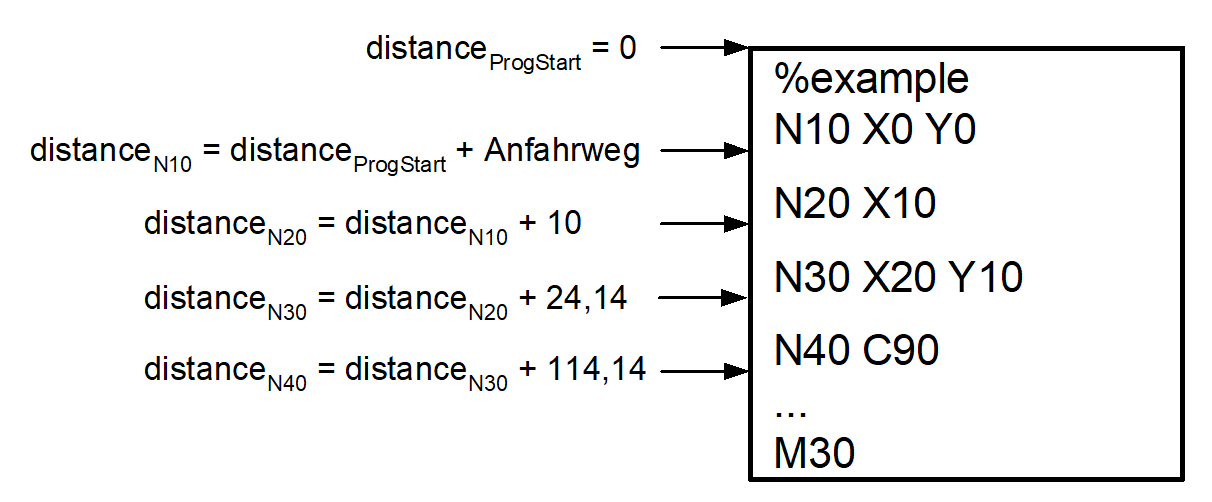

Distance covered from program start (#DISTANCE PROG START)
Distance from program start
Every motion block can be identified by the covered distance from program start. The distance is displayed on the PLC interface during the process (see section HLI: Covered distance - path increments, section Covered distance - path increments). The distance is formed as the sum of the main axis motions of all previous motion blocks. If a motion block contains no main axis motion, the distance of the tracking axis that moves at its dynamic limit is added.
Distance covered from program start (#DISTANCE PROG START) 1:
To approach the identical position in the block search, the original contour may not be changed in the definition of position by distance. This means that, if tool radius compensation is active, an identical tool must be replaced in block search.
However, if starting is executed with different tool geometries, the “Distance from program start” changes.

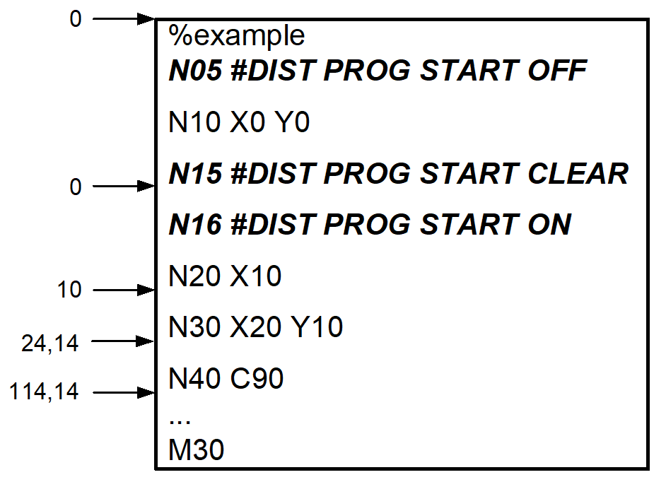

Distance display, NC commands
To render this independent of the starting axis position, the distance display can be controlled by the following commands in the NC program.
#DISTANCE PROG START ON
modal
#DISTANCE PROG START OFF
modal
#DISTANCE PROG START CLEAR
non-modal
ON
Distance of following motion blocks is evaluated for display (default after program start).
OFF
Distance of following motion blocks is not evaluated for display.
CLEAR
The current distance is set to 0 (default at program start)
Distance covered from program start (#DISTANCE PROG START) 2:
Influence of starting movement is prevented by NC commands

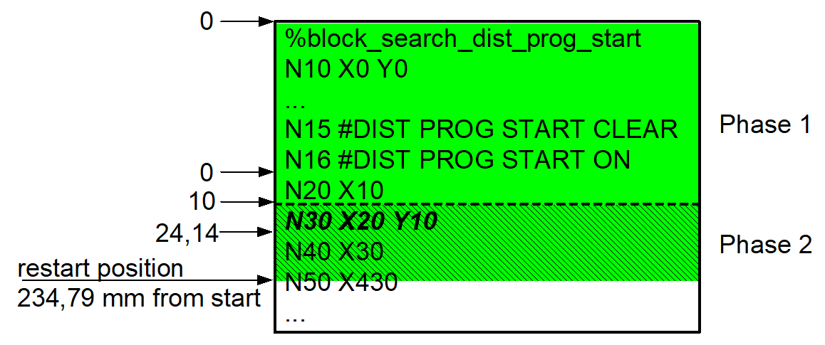

Position in block by distance
If a block is stopped or interrupted, the actual distance from program start can be read on the PLC interface (see section HLI: Covered distance - path increments) and the continuation position can be specified more exactly by this distance display.
Example
Continuation position with current block split by distance from program start
Block search type                                4
Block number                                 30
Distance since program start        16 mm
Continuation position is within block N30
Distance covered from program start (#DISTANCE PROG START) 3:
Example
Search for continuation position by distance from program start over several blocks
Block search type                          4
Block number                                 30
Covered distance         234.79 mm
Continuation position is within block N50
Distance covered from program start (#DISTANCE PROG START) 4:

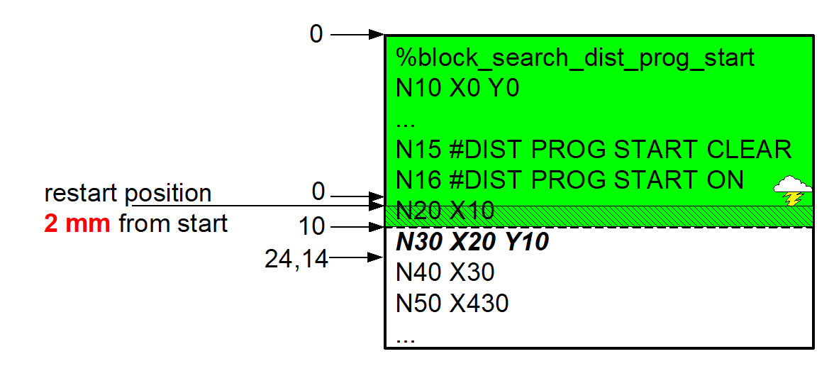

The continuation position can only be moved by tracking, i.e. towards program end, beyond the specified block limit (solid green section).
Moving the continuation position to a position already skipped in block search is not possible. This is prevented and a warning is output.
Example
Continuation position by distance from program start before current block
Block search type                     4
Block number                            30
Covered distance         2 mm
Continuation position is within block N20
Warning is output
Distance covered from program start (#DISTANCE PROG START) 6:
