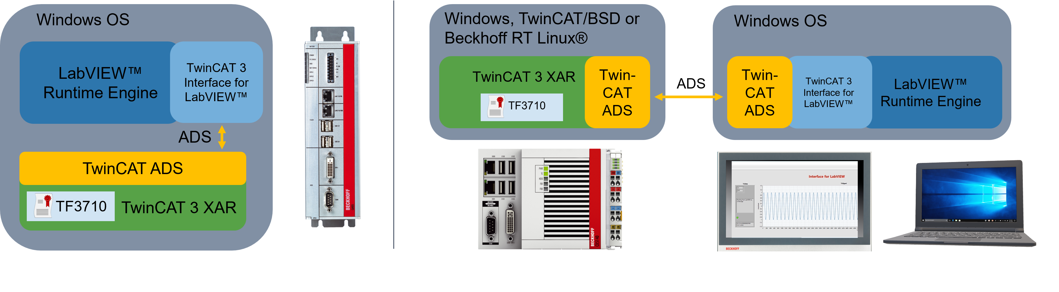

Please observe the following distinction: the TF3710 license is required on the TwinCAT runtime environment. The components of the TF3710 TwinCAT 3 Interface for LabVIEW™, on the other hand, are required on the system with the LabVIEW™ installation.

It should be noted that the TwinCAT and LabVIEW™ runtimes can be installed on the same system or on separate systems connected via a network.
