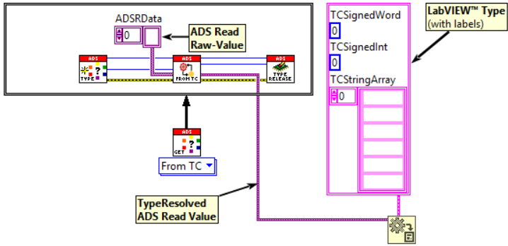

Resolve ADS data stream from TwinCAT 3
The block From TC initializes the TypeResolver, parses and converts the ADS data read from TwinCAT with ADS Read into the LabVIEW™ data type Variant. The block Type Release releases the TypeResolver from memory. Variant is converted to the appropriate LabVIEW™ data type via Variant-to-Data VI.
The following graphic shows how the composition of TypeResolver from the Low Level VIs. In this example we assume a structure in TwinCAT that consists of three elements.
Definition of the structure:
TYPE ST_toLabVIEW :
STRUCT
TCSignedWord : INT;
TCUnsignedInt : UINT;
TCStringArray : ARRAY [1..5] OF STRING;
END_STRUCT
END_TYPEThe TwinCAT 3 data type and the LabVIEW™ data type must match for the conversion process. In the appendix you will find a translation table as an overview. On the right side of the block diagram is a LabVIEW™ container that mirrors the above structure.
Structure of the LabVIEW™ container (not initialized, merely defined):
- I16
- U16
- TCStringArray is 1..n Elements and of type string (not further specified in LabVIEW™)
Copying data may fail for the following reasons:
- The elements of the LabVIEW™ container are not configured in the correct order.
- The entries of the structure and the container do not have the same data type.

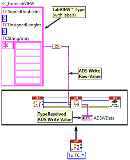

Resolve ADS data stream for TwinCAT 3
The block To TC initializes the TypeResolver, compares the LabVIEW™ data type with the TwinCAT 3 data type and converts the LabVIEW™ data into ADS raw data. The block then releases the TypeResolver from the memory. The converted ADS data can then be passed directly to an ADS Write block.
The diagram below shows a similar scenario as described earlier for From TC. In this case the data are converted from a LabVIEW™ data type to a TwinCAT 3 data type. The conversion may fail for the following reasons:
- The elements in the structure are not initialized.
![]() | Initialization of the LabVIEW™ data type When converting from LabVIEW™ to TwinCAT 3 data type, the LabVIEW™ data type must be pre-initialized. For a complex data type, such as a structure, the complete data type must be initialized. For an array the individual elements must be initialized. |
For the diagram above, for example, the following TwinCAT structure is conceivable in the PLC as a target for writing:
TYPE ST_fromLabVIEW :
STRUCT
TCSignedDoubleInt : DINT;
TCUnsignedLongInt : ULINT;
TCStringArray : ARRAY [1..6] OF STRING(80);
END_STRUCT
END_TYPEThe matching initialized LabVIEW™ container is then structured as follows:
- I32
- U64
- String array with 6 elements (80 characters per array element may be used here)
