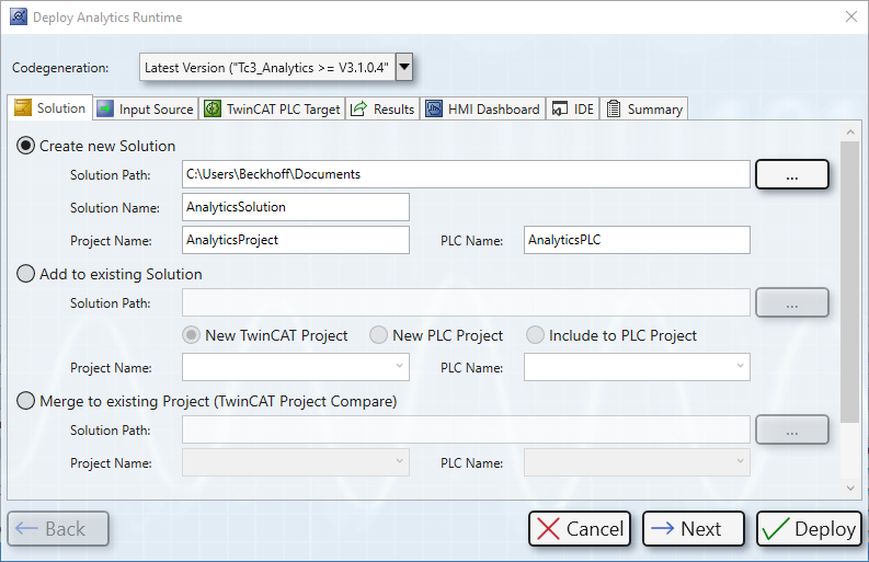

 - 2. The Deploy Wizard starts and it is possible to set up the entire required configuration step by step for use.
 - 3. On the first tab Solution you can select whether a new project folder is created, whether the analysis PLC code is integrated or added to an existing project folder as a new project, new PLC or to an existing PLC, or whether the new project is inserted into an existing project folder using the TwinCAT Project Compare Tool.

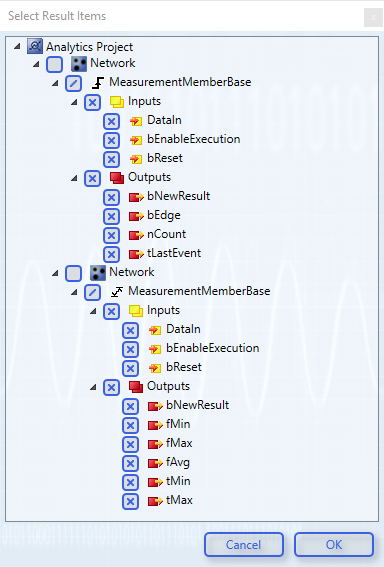

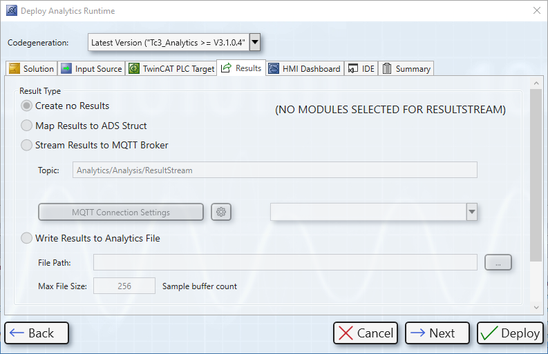

 - 5. If you have set the "PLC Result" property of some functions in the configurator, the Result tab is enabled in the Deploy wizard. There you can set up where the results will be streamed or stored.
 - 6. By clicking Select Result Items it is possible to select only the desired values.

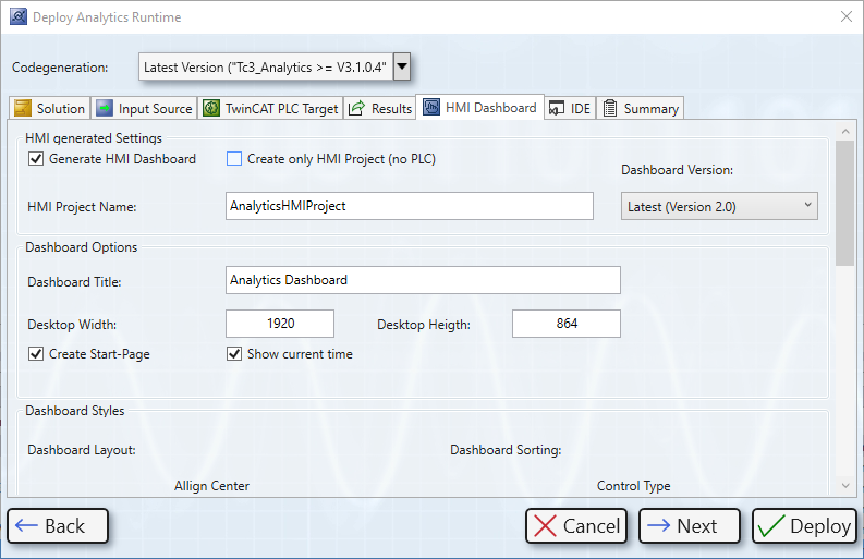

 - 7. If you have assigned HMI controls to one or more functions, the HMI Dashboard tab is enabled in the Deploy wizard. Here, various settings can be made to generate a customized Dashboard that fits your needs.

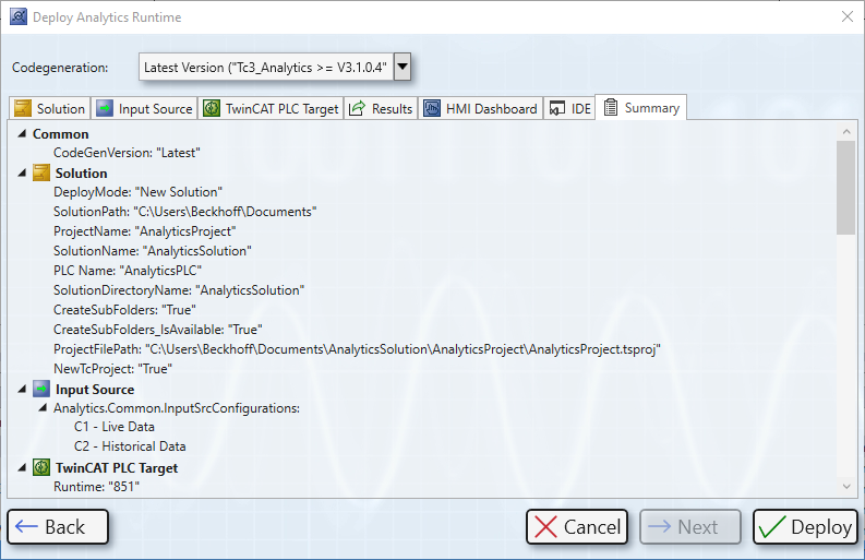

 - 9. The last tab shows you all the settings you have made for the generation. Now you can start the generation process by clicking Deploy.
- In the overview window, each step during the generation process is displayed, clearly arranged and divided into categories.
