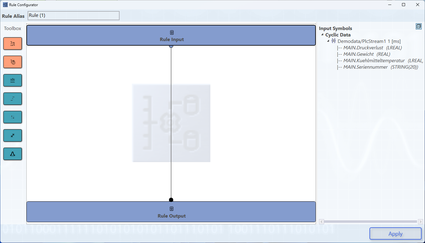

A rule is edited in the Rule Configurator. An alias name can be assigned to a rule at the top left. A rule consists of the following elements:
Rule Input:
Corresponds to the start point within a rule. All symbols added to the rule are displayed here. For BatchDataRules, the time range for which the data is loaded when the rule is triggered can be selected here.
Rule Output:
Corresponds to the output of the rule. All symbols of the blocks that are connected to the rule output can be selected for subsequent recordings.

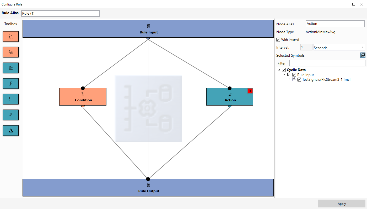

Editing rules 1:
Additional blocks can be added for processing via the toolbox (left). A distinction is made between Condition blocks and Action blocks. Condition blocks serve as filters and enable incoming data to be filtered on a time basis or data basis. Action blocks offer the option of aggregating data (e.g. calculating min/max/avg or other operations). All blocks can be linked to each other with connections.

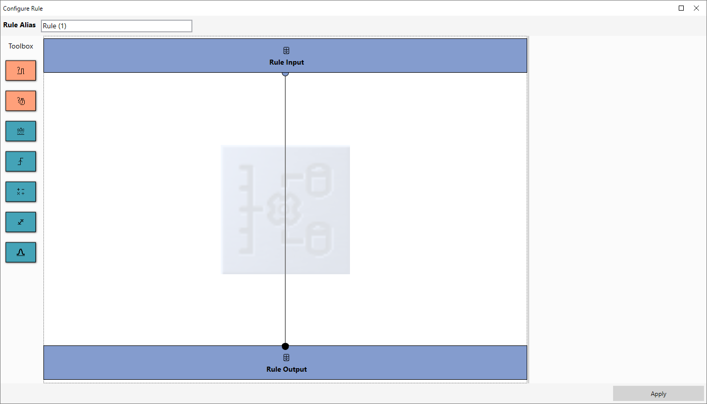

Editing rules 2:
