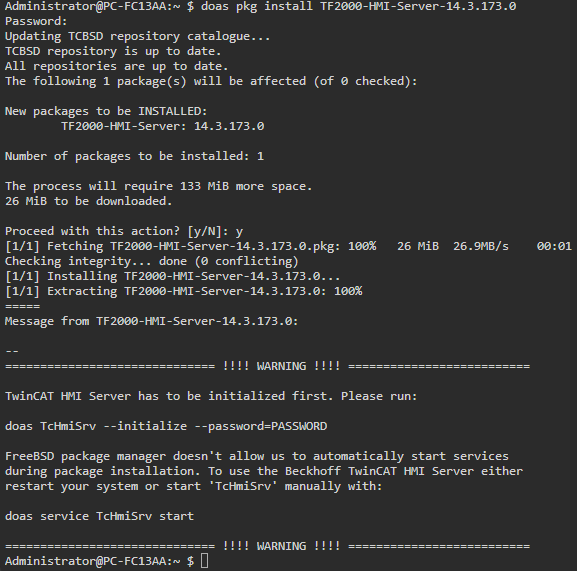

TwinCAT/BSD 1:
The server has been installed successfully.
/usr/local/etc/TwinCAT/Functions/TF2000-HMI-Server
doas pkg install TF2000-HMI-Server-<Version>
6. Initialize the HMI server.
Initialization under TwinCAT/BSD
7. Start the server.
TwinCAT/BSD 2:
The server has been successfully started.
doas service TcHmiSrv start
