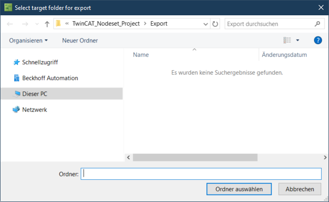

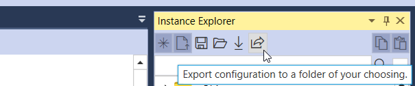

To deploy the project to a TwinCAT OPC UA Server that is not installed locally, click on the Export configuration to a folder of your choosing button in the Instance Explorer toolbar.
A selection dialog opens, which opens in the export directory (see Application and project settings) by default.

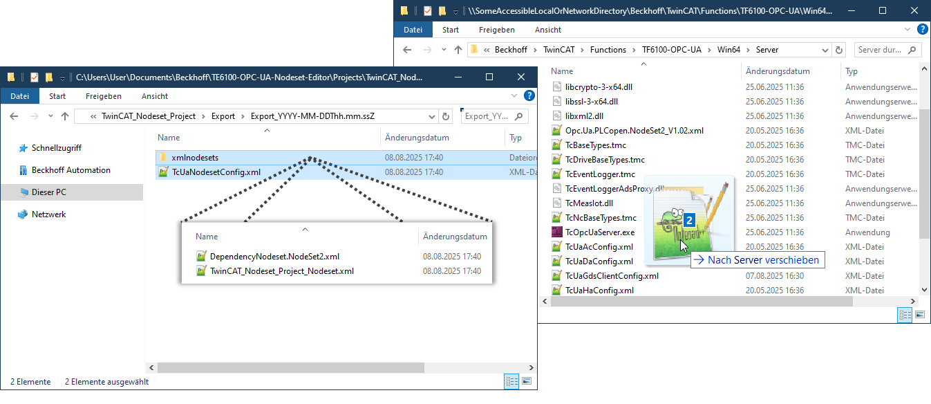

Once a folder has been selected, the project nodeset, including any necessary dependencies, is exported to this folder and a corresponding configuration file is created for the server. The entire contents of the folder can then be copied manually to a current TwinCAT 3 OPC UA Server (see Use cases). If direct file access is possible, this can simply be done via Explorer, for example:
