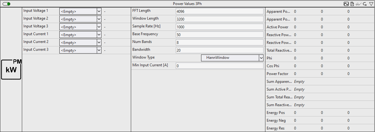

Configuration parameters
- FFT Length: Length of the FFT. It must be greater than one and an integral power of two.
- Window Length: Length of the analysis window in samples. The length must be greater than one and an even number. It must not be greater than FFT Length.
- Sample Rate [Hz]: Sample rate (samples per second) of the input signal.
- Base Frequency: Frequency of the first harmonic in Hz.
- Num Bands: Specifies the number of bands for which the RMS is calculated.
- Bandwidth: Total bandwidth of a single RMS band.
- Window Type: Defines the window function used. The window type HannWindow is a good default value. The windowing can be switched off by the use of the window type RectangularWindow. See: E_PMA_WindowType
- Min Input Current [A]: Minimum input value (RMS) of the current. This parameter prevents the calculation of input values that are too small.
Input values
- Input Voltage 1 .. Input Voltage 3: Input values of the voltage.
- Input Current 1 .. Input Current 3: Input values of the current.
- Reset Statistics (optional):
TRUEresets the min. and max. values of the outputs.
Output values
- Apparent Power: Total apparent power.
- Apparent Power 1: Fundamental apparent power.
- Active Power: Active power.
- Reactive Power d: Distortion reactive power.
- Reactive Power 1: Fundamental shift reactive power.
- Total Reactive Power: Total reactive power.
- Phi: Phase shift angle.
- Cos Phi: CosPhi (active power/fundamental apparent power).
- Power Factor: Power factor (active power/total apparent power).
- Power Quality Factor: Represents the quality of the power supply simplified in a value range between 0 and 1. The frequency, the RMS value of the voltage and the THD of the voltage are also included.
- Energy Pos: Energy in positive direction.
- Energy Neg: Energy in the negative direction.
- Energy Res: Resulting energy.
- Sum Apparent Power: Sum of the total apparent power of all phases.
- Sum Active Power: Sum of the active power of all phases.
- Sum Total Reactive Power: Sum of the total reactive power of all phases.
- Sum Reactive Power 1 Res: Sum of the values of the fundamental shift reactive power of all phases.
