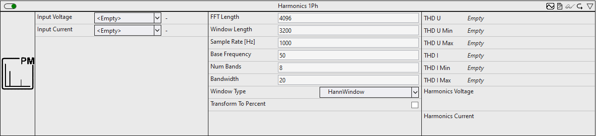

The Harmonics module calculates the harmonics of current and voltage. In addition, the THD of the input values is calculated from the harmonics.

Configuration parameters
- Num Harmonics: Number of harmonics to be calculated.
- Transform To Percent: Boolean value that specifies whether the result should be output as a percentage. The first harmonic corresponds to 100%.
- FFT Length: Length of the FFT. It must be greater than one and an integral power of two.
- Window Length: Length of the analysis window in samples. The length must be greater than one and an even number. It must not be greater than FFT Length.
- Sample Rate [Hz]: Sample rate (samples per second) of the input signal.
- Base Frequency: Frequency of the first harmonic in Hz.
- Num Bands: Specifies the number of bands for which the RMS is calculated.
- Bandwidth: Total bandwidth of a single RMS band.
- Window Type: Defines the window function used. The window type HannWindow is a good default value. The windowing can be switched off by the use of the window type RectangularWindow. See: E_PMA_WindowType
Input values
- Input Voltage: Input values of the voltage.
- Input Current: Input values of the current.
- Reset Statistics (optional):
TRUEresets the min. and max. values of the outputs.
Output values
- THD U: THD of the voltage. The output is in percent.
- THD U Min: Minimum THD U value that has occurred. Can be reset via the Reset Statistics input.
- THD U Max: Maximum THD U value that has occurred. Can be reset via the Reset Statistics input.
- THD I: THD of the current. The output is in percent.
- THD I Min: Minimum THD I value that has occurred. Can be reset via the Reset Statistics input.
- THD I Max: Maximum THD I value that has occurred. Can be reset via the Reset Statistics input.
- Harmonics Voltage: Harmonics of the voltage.
- Harmonics Current: Harmonics of the current.
