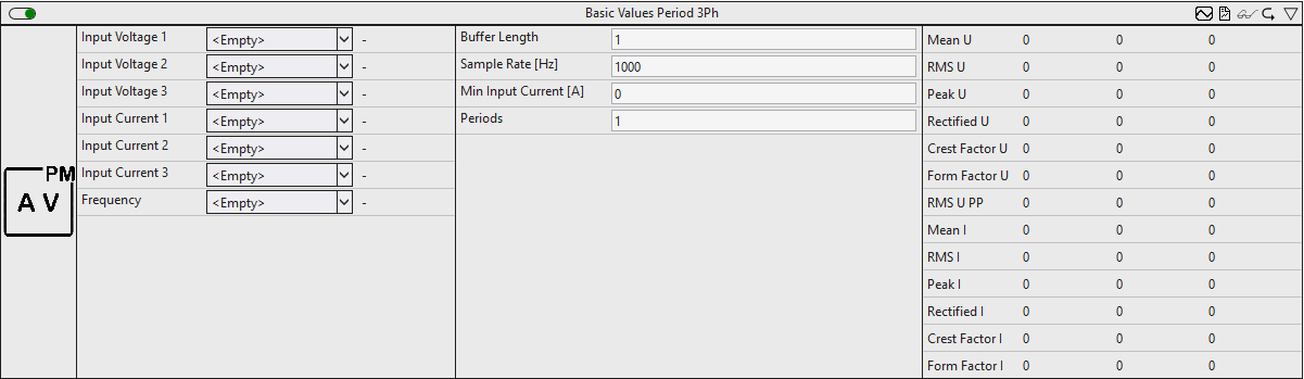

Configuration parameters
- Buffer Length: Length of the input buffer.
- Sample Rate [Hz]: Sample rate (samples per second) of the input signal.
- Min Input Current [A]: Minimum input value (RMS) of the current. This parameter prevents the calculation of input values that are too small.
- Periods: Number of periods that influence the calculation. (Period length = sample rate/frequency).
Input values
- Frequency: Current frequency of the input signal. Is used to determine the length of the period at the beginning of a period. The output of the Frequency Period1 Ch module can be used.
- Input Voltage 1 .. Input Voltage 3: Input values of the voltage.
- Input Current 1 .. Input Current 3: Input values of the current.
- Reset Statistics (optional):
TRUEresets the min. and max. values of the outputs.
