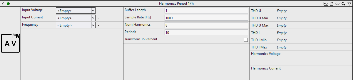

Configuration parameters
- Buffer Length: Length of the input buffer.
- Sample Rate [Hz]: Sample rate (samples per second) of the input signal.
- Min Input Current [A]: Minimum input value (RMS) of the current. This parameter prevents the calculation of input values that are too small.
- Periods: Number of periods that influence the calculation. (Period length = sample rate/frequency).
- Num Harmonics: Number of harmonics to be calculated.
- Transform To Percent: Boolean value that specifies whether the result should be output as a percentage. The first harmonic corresponds to 100%.
Input values
- Frequency: Current frequency of the input signal. Is used to determine the length of the period at the beginning of a period. The output of the Frequency Period1 Ch module can be used.
- Input Voltage: Input values of the voltage.
- Input Current: Input values of the current.
- Reset Statistics (optional):
TRUEresets the min. and max. values of the outputs.
Output values
- THD U: THD of the voltage. The output is in percent.
- THD U Min: Minimum THD U value that has occurred. Can be reset via the Reset Statistics input.
- THD U Max: Maximum THD U value that has occurred. Can be reset via the Reset Statistics input.
- THD I: THD of the current. The output is in percent.
- THD I Min: Minimum THD I value that has occurred. Can be reset via the Reset Statistics input.
- THD I Max: Maximum THD I value that has occurred. Can be reset via the Reset Statistics input.
- Harmonics Voltage: Harmonics of the voltage.
- Harmonics Current: Harmonics of the current.
