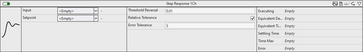

Standard HMI Controls
For the Step Response 1Ch algorithm, the following HMI controls are available for generating an Analytics Dashboard:
1. The Table Control and Multivalue Control visualize all output values.
Alternatively, customer-specific HMI controls can be mapped using the Mapping Wizard.
