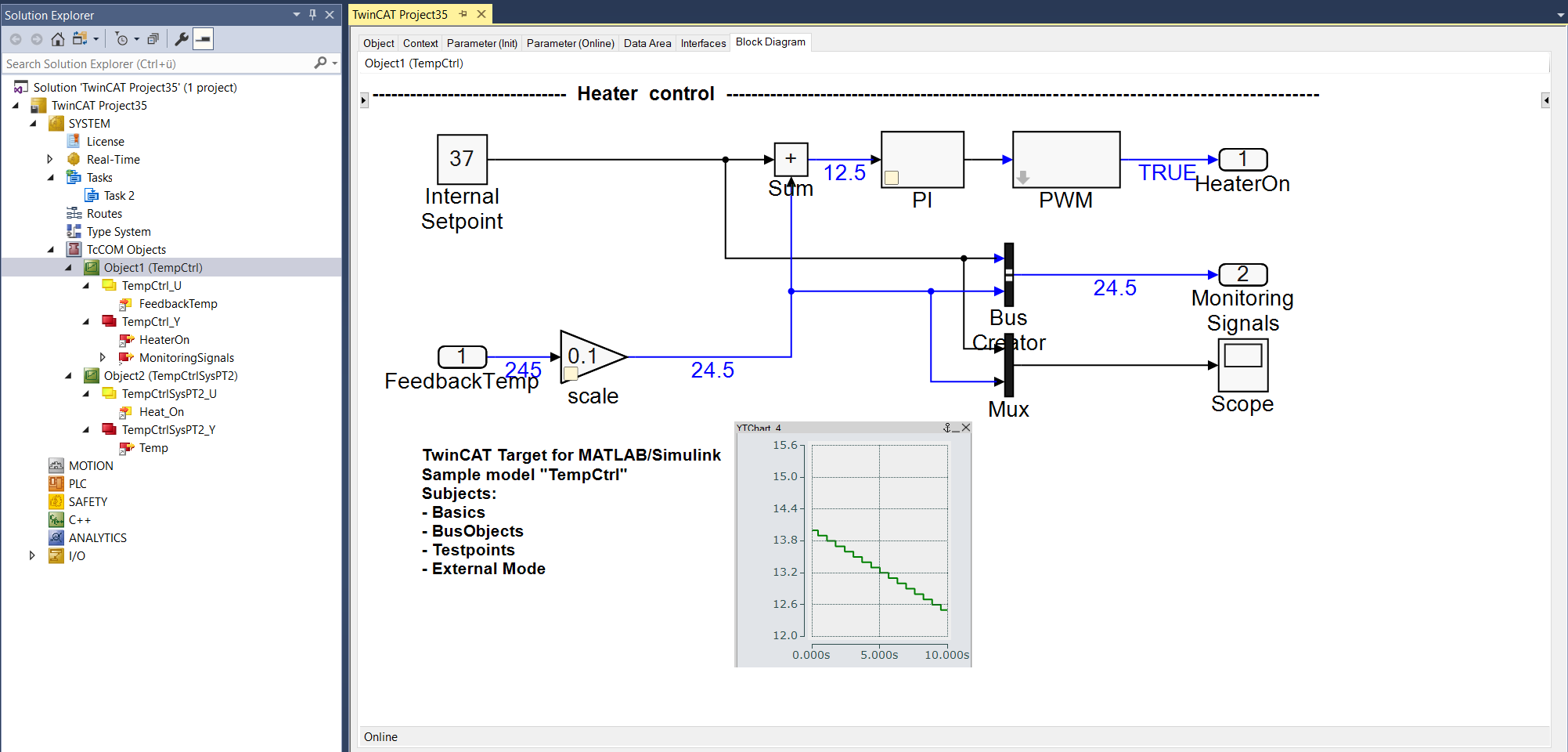

- After activating the configuration, you can observe the behavior of the objects and change parameters in the block diagram.
