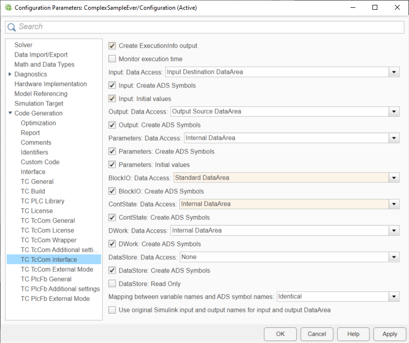

Enter model parameters as tunable
The Simulink Coder™ model parameters are set as "inlined" as the default behavior. This means that the object memory used is smaller and the generated code is optimized in terms of runtime, but often only a few parameters can be changed at runtime with this setting.
Use the Configuration Parameter under Optimization > Default parameter behavior "Tunable" so that you can parameterize your model at runtime.
For a description of the setting options, see Configuration of data access to data of a TcCOM object.

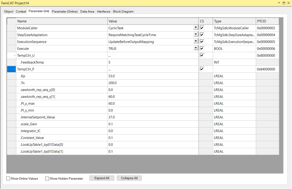

Possible parameter settings in Parameter (Init)

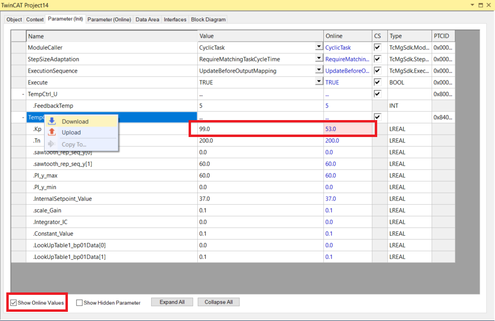

Module parameters can be found in Parameter (Init), which do not change cyclically but can be changed acyclically. No online values can be seen in Config mode, or when the TcCOM is not started.
Parameterization of a module instance 4:
Define Startup Values
Startup Values can be set in the Parameter (Init) representation or in the Block Diagram representation (see in the following chapter). To do this, select the entry in the Value column that you want to adjust on the module instance and enter a value. The value set in this way is only available in the project file in the XAE at this time. Activate Configuration loads the set value (with the overall project) to the target system.
Settings such as the ModuleCaller, StepSizeAdaption or ExecutionSequence cannot be changed at runtime of the module, but they can only be defined as startup values. Other module parameters such as Execute or the model parameters can also be changed online.
Change values online
If the TcCOM module is active, you can use Show Online Values to make the current values of the instance visible. You can enter a new value in the Value column, making it a Prepared Value. If the Prepared Value is not yet loaded on the target system, the field with deviation between Value and Online appears with red marking. Once all changes have been made, you can right-click at the structure level and use "Download" to set the prepared values in the target system. Note that this does not change the startup value of the instance on the target system. To do this, you must first activate the current configuration on the target system. Likewise, you can use "Upload" to set the current Online Values as Startup Values in the project. Again, the change is not active on the runtime system until the project is compiled and downloaded, see Best practice: access to TcCOM data.

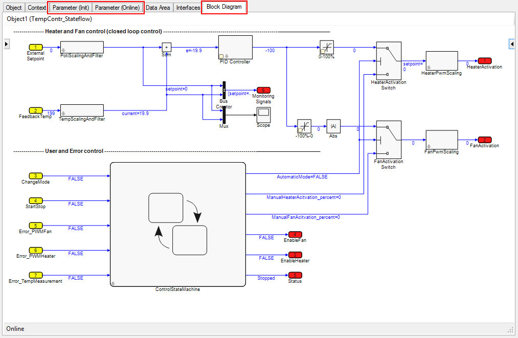

All parameters in the parameter range (right side of the window) are only displayed in the TwinCAT 3 block diagram if you are in the top level of the block diagram ("<root>"). If you are in a subsystem or if you have selected a block, only the parameters of the active block are displayed.

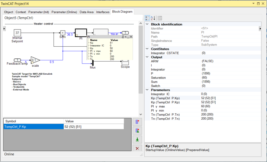

In the block diagram you have the possibility to read and write online values as well as to change Startup Values.
Parameterization of a module instance 6:
Select a block with a yellow dot in the lower left corner. If you click directly on the yellow dot, a context menu opens in which you can see the online values of the block and also change them. If you change a value, it will be entered in the Prepared list. When you have made all the changes, you can write the prepared values to the target system. You can select in the Prepared list whether you want to set the prepared values as Online and/or Startup values.

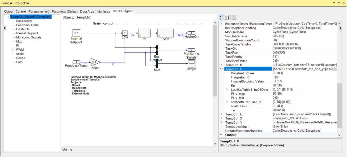

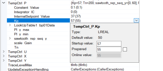

You can also go over the parameter list in the right area of the block diagram and change values here. Find the parameter you want to change and click the down arrow on the right side of the list. Here you can make changes in the editable fields. If you move the mouse pointer over the parameter name (TempCtrl_P.Kp in the following diagram), the ADS address information is displayed. By right-clicking on the parameter name, you can copy the parameter's ADS address information to the clipboard.
Parameterization of a module instance 8:

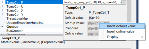

You can also change entire structures. Select the <ModelName>_P structure, for example, i.e. the structure that contains all model parameters, and select the downward pointing arrow here. A context menu appears by right-clicking on Startup Values, for example. Here you can set all current online values of the structure as Startup Values, or you can reset the startup list to the default values.

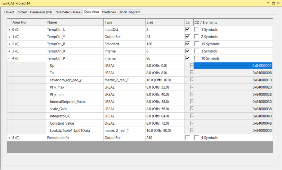

Interaction with DataAreas
You cannot change DataAreas via the XAE. You can only see the DataArea type (see Type column) and deduce which interaction options are possible with the DataArea, see Configuration of data access to data of a TcCOM object.
Via the CS column you can see whether ADS symbol names are to be generated for this DataArea. CS is editable by the user. If CS is enabled, you can use the Target Browser, for example, to search for the ADS symbols and include them in a scope configuration. If CS is disabled, you can only access the DataArea data via Index Group and Index Offset. Index Group is the Object ID of the instance (see Object tab) and Index Offset is displayed in the CD / Elements column.
