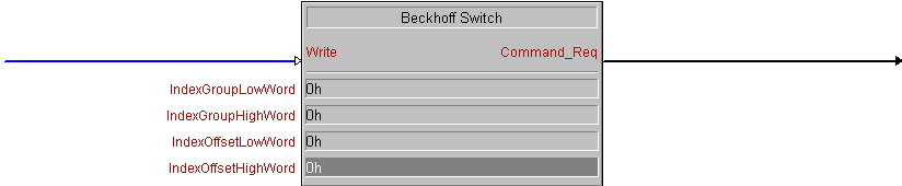

Beckhoff Switch
This block writes the value '1' for a positive edge at input Write and the value '0' for a negative edge at input Write to a TwinCAT PLC.
Inputs
Write : DIGITAL;
Write: Value '1' is written via a positive edge at this input, value '0' is written via a negative edge.
Outputs
Command_Req : SERIAL;
Command_Req: This signal is connected to the Command_Req-input of the Beckhoff Communication or Beckhoff Communication 400 block. It is used for transferring commands.
Parameters
IndexGroupLowWord : ANALOG;
IndexGroupHighWord : ANALOG;
IndexOffsetLowWord : ANALOG;
IndexOffsetHighWord : ANALOG;
IndexGroupLowWord: The low-order word of the Index Group.
IndexGroupHighWord: The high-order word of the Index Group.
IndexOffsetLowWord: The low-order word of the Index Offset.
IndexOffsetHighWord: The high-order word of the Index Offset.
