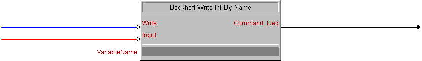

This block writes the value of the 16-bit variable that is present at the Input to a TwinCAT PLC.
Inputs
Write  :  DIGITAL;
Input  :  ANALOG;
Write: The write command is activated by a positive edge at this input.
Input: This value will be transferred.
Outputs
Command_Req  :  SERIAL;
Command_Req: This signal is connected to the Command_Res input of the Beckhoff Communication or Beckhoff Communication 400 lock. It is used for transferring commands.
Parameters
VariableName  :  SERIAL;
VariableName: Specifies the name of the variable to be described in the TwinCAT PLC.
