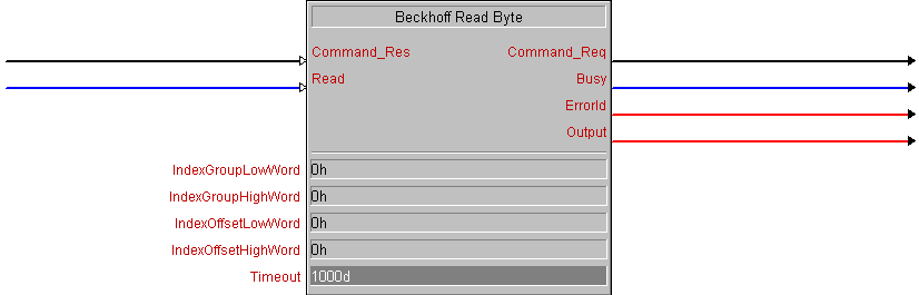

Beckhoff Read Byte
Beckhoff Read Byte 1:
This block reads an 8-bit variable from a TwinCAT PLC and makes it available as an analog signal at the output.
Inputs
Command_Res  :  SERIAL;
Read         :  DIGITAL;
Command_Res: This signal is connected to the Command_Res output of the Beckhoff Communication or Beckhoff Communication 400 block. It is used for transferring feedback.
Read: The read command is activated via a rising edge at this input.
Outputs
Command_Req  :  SERIAL:
Busy         :  DIGITAL;
ErrorId      :  ANALOG;
Output       :  ANALOG;
Command_Req: This signal is connected to the Command_Req input of the Beckhoff Communication or Beckhoff Communication 400 block. It is used for transferring commands.
Busy: During the transfer the output is set and remains active until the signal has been read. During this time no further read commands can be activated via this block.
ErrorId: This analog signal contains the error code that may occur during command execution. If no error has occurred, this signal has the value 0.
Output: The value that was read is output via this analog signal.
Parameters
IndexGroupLowWord    :  ANALOG;
IndexGroupHighWord   :  ANALOG;
IndexOffsetLowWord   :  ANALOG;
IndexOffsetHighWord  :  ANALOG;
Timeout              :  ANALOG;
IndexGroupLowWord: The low-order word of the Index Group.
IndexGroupHighWord: The high-order word of the Index Group.
IndexOffsetLowWord: The low-order word of the Index Offset.
IndexOffsetHighWord: The high-order word of the Index Offset.
Timeout: Specifies the interval for awaiting a response. The unit is ms.
