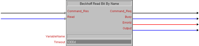

This block reads a Boolean variable from a TwinCAT PLC and makes it available as a digital signal at the output.
Inputs
Command_Res  :  SERIAL;
Read         :  DIGITAL;
Command_Res: This signal is connected to the Command_Res output of the Beckhoff Communication or Beckhoff Communication 400 block. It is used for transferring feedback.
Read: The read command is activated via a rising edge at this input.
Outputs
Command_Req  :  SERIAL;
Busy         :  DIGITAL;
ErrorId      :  ANALOG;
Output       :  DIGITAL;
Command_Req: This signal is connected to the Command_Req input of the Beckhoff Communication or Beckhoff Communication 400 block. It is used for transferring commands.
Busy: During the transfer the output is set and remains active until the signal has been read. During this time no further read commands can be activated via this block.
ErrorId: This analog signal contains the error code that may occur during command execution. If no error has occurred, this signal has the value 0.
Output: The value that was read is output via this digital signal.
Parameters
VariableName  :  SERIAL;
Timeout       :  ANALOG;
VariableName: Specifies the name of the variable to be read in the TwinCAT PLC.
Timeout: Specifies the interval for awaiting a response. The unit is ms.
