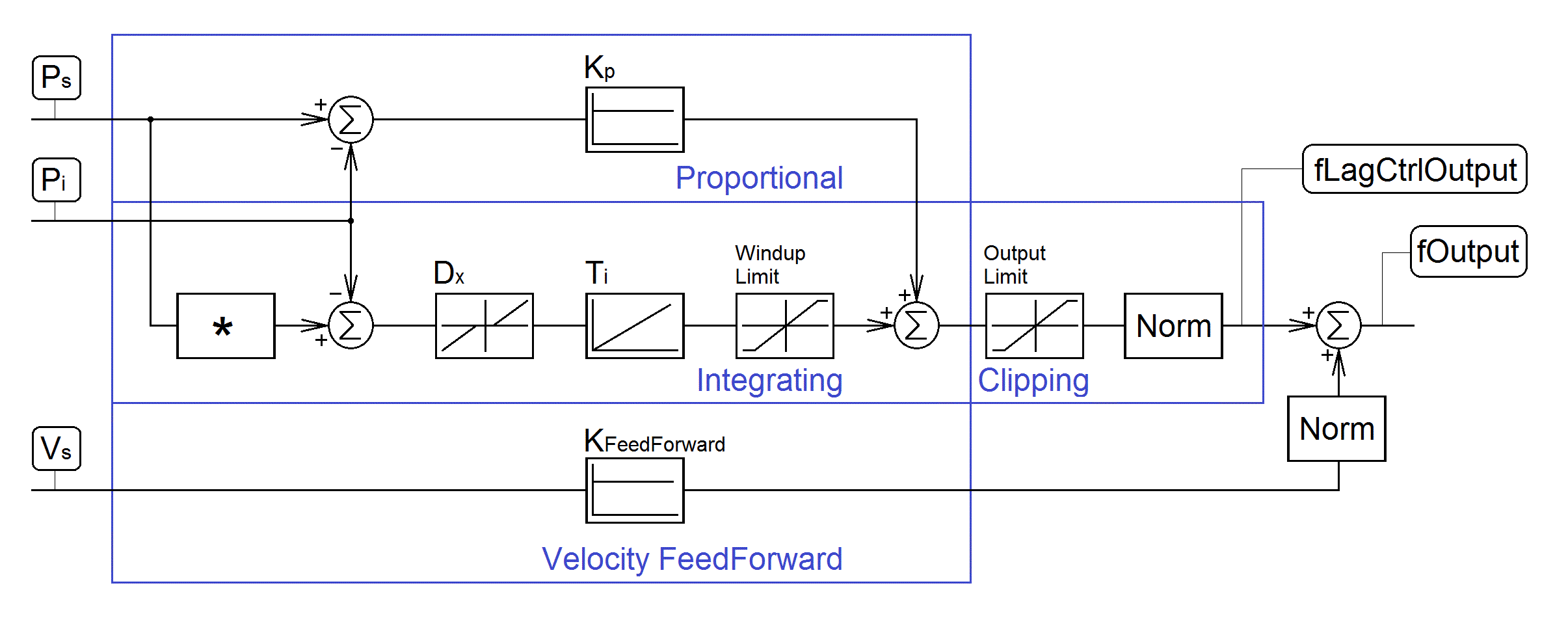

Structure of the controller
![]() | The Ti parameter is used by this controller as Ki. A value of 0.0 disables the I part. Increasing values generate increasingly strong reactions of the I part. |
