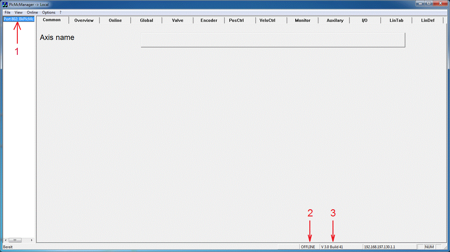

In the current versions the PlcMcManager is prepared for use under TC3. To establish the connection at runtime, it checks the expected ADS addresses for both TC2 and TC3. This may take several seconds, particularly if a network connection is used. The details shown below should then appear.
- Shows the port and the server used for the communication with the runtime system.
- The mode is displayed. Since no axis has been selected up to this point, the PlcMcManager is still in OFFLINE mode.
- Shows the version information of the library used by the PLC application.

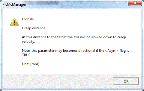

Many parameter input fields have a "?" field on the left-hand side. This can be used to call up a brief explanation of the parameter.
Sample: Explanation of the parameter <Global.CreepDistance>:

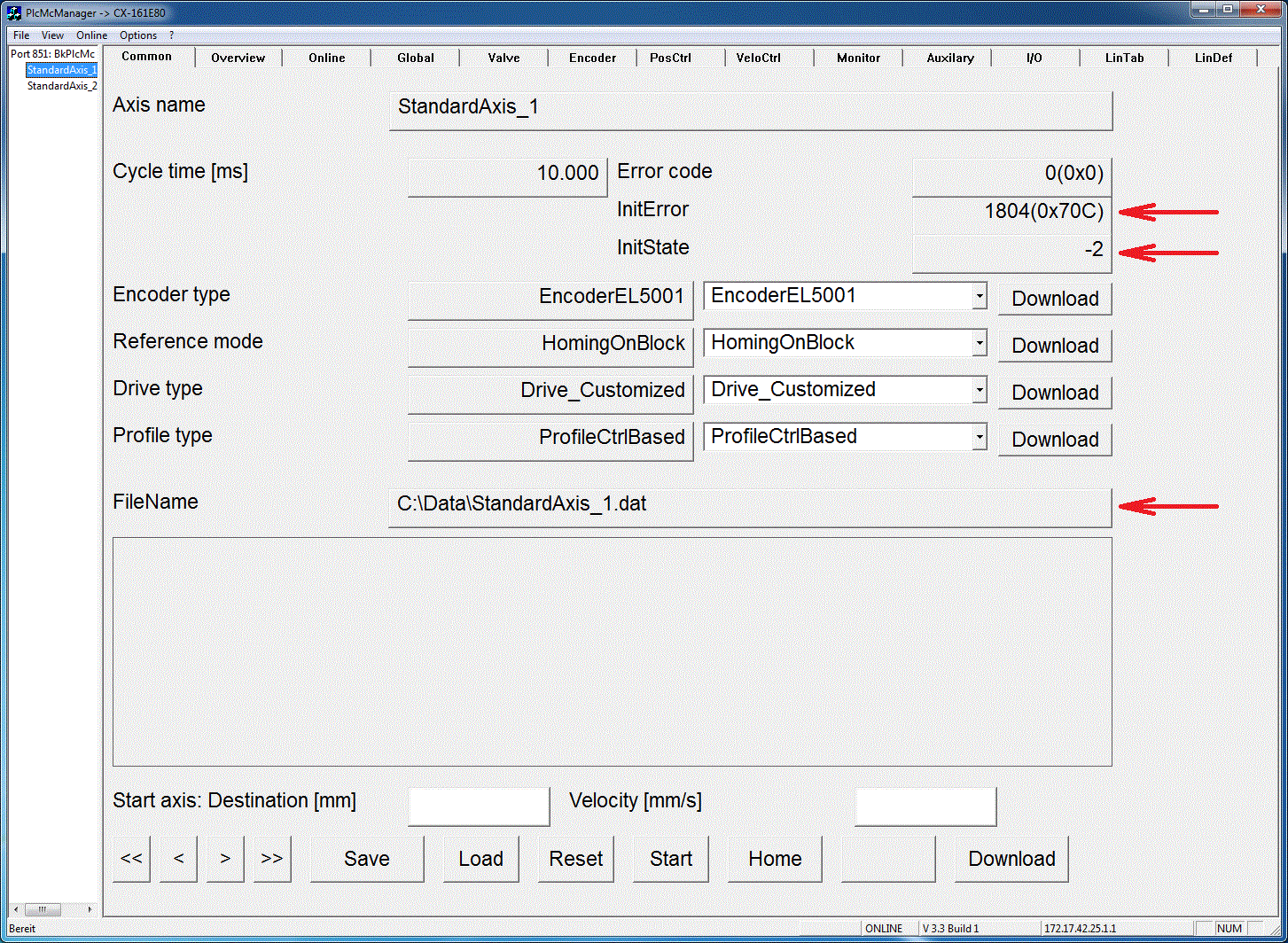

Double-clicking on the server shown on the left displays the axes used in the application as a list. Click on an axis to select it. Its status is then cyclically updated, and its parameter are accessible. If the communication fails for some reason, it can be restarted by clicking on an axis.
This example shows the file path and name used for this axis. However, an InitError 1804 (0x70C) and an InitState of -2 are reported. The error code indicates a file error and the InitState is "negative terminated". There are several possible causes for this:
- The path does not exist on the computer where the PLC application is running. Problems can easily arise if the application goes online for the first time on another system.
- The path is not accessible from the location of the PLC runtime. This is possible, for example, if the path points to a network.
- Reading and/or writing is not allowed on this path.
- The path or file name is not spelled correctly. The backslash may be missing at the end of the path name.
- There is no corresponding file under the specified path name.
The last cause listed always occurs when commissioning of a PLC application is started without an existing file. To create a file with default parameters, press the [Save] key to initiate a write operation with the initial parameter values. The [Reset] key deletes the error state, and in this case the loading of the parameters from the file is repeated. If the problem cannot be solved by this procedure, it is caused by another of the listed causes.
