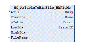

MC_AxTableToBinFile_BkPlcMc (from V3.0)
The function block writes the contents of a table to a binary file.
Inputs
Execute: BOOL:=FALSE;
pTable: POINTER TO LREAL:=0;
LowIdx: INT:=0;
HighIdx: INT:=0;
FileName: STRING(255):='';
Name | Type | Description |
Execute | BOOL | The writing process is initiated by a rising edge at this input. |
pTable | POINTER TO LREAL | This parameter is used to transfer the address of an ARRAY[nFirstIdx..nLastIdx,1..2]. |
LowIdx | INT | This parameter is used to transfer the lower index of the ARRAY, whose address is transferred as pTable. |
HighIdx | INT | This parameter is used to transfer the upper index of the ARRAY, whose address is transferred as pTable. |
FileName | STRING | This parameter can be used to specify a file name. |
Inputs/outputs
VAR_INOUT
Axis: Axis_Ref_BkPlcMc;
Axis | Axis_Ref_BkPlcMc | Here, the address of a variable of type Axis_Ref_BkPlcMc should be transferred. |
Outputs
Busy: BOOL;
Done: BOOL;
Error: BOOL;
ErrorID: UDINT;
Busy | BOOL | Indicates that a command is being processed. |
Done | BOOL | Successful processing of the homing is indicated here. |
A rising edge at Execute causes the function block to check the transferred parameters. A number of problems can be detected and reported during this process:
- If LowIdx is negative the system responds with Error and ErrorID=dwTcHydErrCdTblEntryCount.
- If pTable=0 the system responds with Error and ErrorID=dwTcHydErrCdTblEntryCount.
- If LowIdx and HighIdx describe a table with less than five rows the system responds with Error and ErrorID=dwTcHydErrCdTblEntryCount.
If these checks were performed without problems, the write operation is started. Busy is TRUE for the duration of the operation. This can lead to some further problems, which are indicated by various error codes. Successful writing of the file is indicated with Done.
A falling edge at Execute clears all the pending output signals. If Execute is set to FALSE while the process is still active, the process that had started continues unaffected. The signals at the end of the process (Error, ErrorID, Done) are made available for one cycle.
If a FileName is specified, it must be complete (including the drive letter and the path, if applicable, always including the file type), since it is used by function block without any further modification or amendment.
If no FileName is specified, the function block uses the path and the file name, which were specified through the MC_AxUtiStandardInit_BkPlcMc function block. File type TBL is used here, to distinguish from the parameter file with file type DAT.
![]() | The file contents cannot be read or modified with an ASCII editor. |
