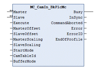

MC_CamIn_BkPlcMc (from V3.0)
The function block starts and monitors a cam plate coupling between two axes. To release the coupling, an MC_CamOut_BkPlcMc function block should be used.

On a rising edge at Execute the function block checks the transferred axis interface. A number of problems can be detected and reported during this process:
- If CamTableId.bValidated was not set by a function block of type MC_CamTableSelect_BkPlcMc, the system responds with Error and ErrorID:=dwTcHydErrCdTblNoInit.
- If either the master or the slave are not in idle state, the system responds with Error and ErrorID:=dwTcHydErrCdNotStartable.
- If the value MC_StartMode_RampIn is specified as StartMode, the function block responds with Error and ErrorID:=dwTcHydErrCdNotSupport.
If these checks could be performed without problem, the coupling is initiated. Depending on StartMode, the reference position for Slave is either set to 0.0 or to the current actual position of Slave. The axis is now in state McState_Synchronizedmotion, and the function block starts calculating and monitoring the coupling.
The set position and set velocity of Slave are calculated depending on the actual position and the set velocity of the master and the table.
When the velocity required by the coupling is reached for the first time while the slave axis coupling is active, this is indicated at output InGear. Since the coupling can currently only be activated at standstill, this is the case immediately. If the slave axis is unable to follow the specifications for some reason while the coupling is active, InGear remains unchanged.
If an error code occurs in the motion generator while the coupling is active, the system responds with Error and ErrorID:=motion algorithm error code.
A falling edge at Execute neither aborts the calculation nor the monitoring of the coupling. This is only brought about if the coupling is activated through an MC_CamOut_BkPlcMc function block or if an error occurs. Only then are all pending output signals cleared.
