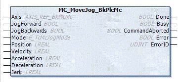

MC_MoveJog_BkPlcMc
This function block starts and monitors the movement of an axis.
Inputs
JogForward: BOOL;
JogBackwards: BOOL;
Mode: E_TcMcJogMode;
Position: LREAL;
Velocity: LREAL;
Acceleration: LREAL;
Deceleration: LREAL
Jerk: LREAL

Inputs/outputs
VAR_INOUT
Axis: Axis_Ref_BkPlcMc;
Name | Type | Description |
Axis | Axis_Ref_BkPlcMc | Here, the address of a variable of type Axis_Ref_BkPlcMc should be transferred. |
Outputs
Busy: BOOL;
Done: BOOL;
CommandAborted: BOOL;
Error: BOOL;
ErrorID: UDINT;
