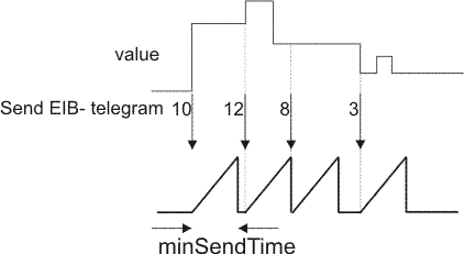

This function block sends a 8-bit EIB value to the set group address. An IEC61131-3 byte variable is available as input value. The data are only transferred if there is a change in the data value. If the value changes again within 1 second, new data are only sent to the EIB device after minSendTime has passed (see diagram). No new EIB telegram is sent if the value changes within the "min. send time" but falls back to the old, already sent value within the "min. send time".
