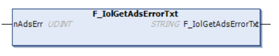

F_IolGetAdsErrorTxt
F_IolGetAdsErrorTxt 1:
Function converts an ADS error into text form.
F_IolGetAdsErrorTxt 2:Inputs
Type
nAdsErr
UDINT
ADS Return Codes
F_IolGetAdsErrorTxt 3:Outputs
Type
F_IolGetAdsErrorTxt
STRING
Displays the ADS return code as text string.
Sample
  hr             :HRESULT;
  nADSError      :E_AdsErr := E_AdsErr.NOERR;
  sADSErrorText  :STRING;
nAdsError := F_IolGetAdsError(hr);
sADSErrorText := F_IolGetAdsErrorTxt(nAdsError);
