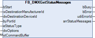

FB_DMXGetStatusMessages
FB_DMXGetStatusMessages 1:
This function block collects the status or error information of an DMX device.
FB_DMXGetStatusMessages 2: Inputs
  bStart                     : BOOL;
  wDestinationManufacturerId : WORD;
  dwDestinationDeviceId      : DWORD;
  byPortId                   : BYTE;
  eStatusType                : E_DMXStatusType := eDMXStatusTypeNone;
  dwOptions                  : DWORD := 0;
Type
bStart
The function block is activated by a positive edge at this input.
WORD
Unique manufacturer Id of the DMX device (for details, see DMX device address).
DWORD
Unique device Id of the DMX device (for details, see DMX device address).
byPortId
BYTE
Channel within the addressed DMX device. Sub-devices are addressed through the Port Id. The root device always has the Port Id 0.
eStatusType
E_DMXStatusType
Status type
dwOptions
DWORD
Options (currently not used).
FB_DMXGetStatusMessages 3: Inputs/outputs
Type
stCommandBuffer
ST_DMXCommandBuffer
Reference to the structure for communication (buffer) with the function block FB_EL6851Communication()
FB_DMXGetStatusMessages 4: Outputs
  bBusy             : BOOL;
  bError            : BOOL;
  udiErrorId        : UDINT;
  arrStatusMessages : ARRAY [0..24] OF ST_DMXStatusMessage;
Type
bBusy
This output is switched to TRUE as soon as an error occurs during the execution of a command. The command-specific error code is contained in udiErrorId. Only valid if bBusy is FALSE.
udiErrorId
UDINT
Contains the command-specific error code of the most recently executed command. Only valid if bBusy is FALSE (see error codes).
arrStatusMessages
ARRAY OF ST_DMXStatusMessage
Once command execution is complete (bBusy is FALSE), all status/error information is available at this output.
