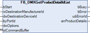

FB_DMXGetProductDetailIdList 1:
This function block queries the categories to which the DMX device belongs.
RDM defines different device categories. Each DMX device can be assigned to up to 6 categories. The assignment is done by the device manufacturer and cannot be changed via RDM.
FB_DMXGetProductDetailIdList 2: Inputs
  bStart                     : BOOL;
  wDestinationManufacturerId : WORD;
  dwDestinationDeviceId      : DWORD;
  byPortId                   : BYTE;
  dwOptions                  : DWORD := 0;
Type
bStart
The function block is activated by a positive edge at this input.
WORD
Unique manufacturer Id of the DMX device (for details, see DMX device address).
DWORD
Unique device Id of the DMX device (for details, see DMX device address).
byPortId
BYTE
Channel within the addressed DMX device. Sub-devices are addressed through the Port Id. The root device always has the Port Id 0.
dwOptions
DWORD
Options (currently not used).
FB_DMXGetProductDetailIdList 3: Inputs/outputs
Type
stCommandBuffer
ST_DMXCommandBuffer
Reference to the structure for communication (buffer) with the function block FB_EL6851Communication()
FB_DMXGetProductDetailIdList 4: Outputs
  bBusy             : BOOL;
  bError            : BOOL;
  udiErrorId        : UDINT;
  arrProductDetails : ARRAY [1..6] OF E_DMXProductDetail;
Type
bBusy
This output is switched to TRUE as soon as an error occurs during the execution of a command. The command-specific error code is contained in udiErrorId. Only valid if bBusy is FALSE.
udiErrorId
UDINT
Contains the command-specific error code of the most recently executed command. Only valid if bBusy is FALSE (see error codes).
arrProductDetails
ARRAY OF E_DMXProductDetail
Contains the list with up to 6 device categories.
