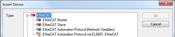

Creating an EtherCAT device
The first step in creating a TwinCAT EtherCAT configuration is to create an EtherCAT device, which may involve either to create an EtherCAT Master, Slave or Automation Protocol (e.g. to use network variables, as covered in a separate article). To create an EtherCAT Master/Slave, simply make use of the ITcSmTreeItem::CreateChild() method with the corresponding parameter for SubType (EtherCAT Master = 111, EtherCAT Slave = 130).
Building an EtherCAT topology 1:
EtherCAT Master - Code Snippet (C#)
ITcSmTreeItem devices = systemManager.LookupTreeItem("TIID");
ethercatMaster = devices.CreateChild("EtherCAT Master", 111, null, null);
EtherCAT Slave - Code Snippet (C#)
ethercatSlave = devices.CreateChild("EtherCAT Slave", 130, null, null);

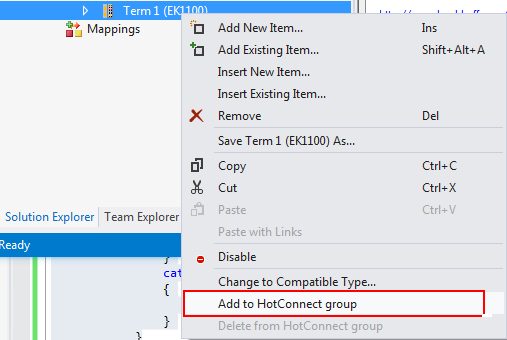

Adding EtherCAT slaves to a HotConnect group
EtherCAT HotConnect allows pre-configured sections to be removed from or added to the data traffic before the start or during operation of the system. For more information about EtherCAT HotConnect please read our EtherCAT System documentation.
In TwinCAT XAE, an EtherCAT slave can be added to a HotConnect group by clicking the corresponding option in the context menu of the device.
Building an EtherCAT topology 8:
In TwinCAT Automation Interface, the same can be achieved by consuming the following XML structure on the EtherCAT slave:
Example (XML description):
<TreeItem>
  <EtherCAT>
    <Slave>
      <HotConnect>
        <GroupName>Term 1 (EK1101)</GroupName>
        <GroupMemberCnt>4</GroupMemberCnt>
        <IdentifyCmd>
          <Comment>read hot connect identity</Comment>
          <Requires>cycle</Requires>
          <Cmd>1</Cmd>
          <Adp>0</Adp>
          <Ado>4096</Ado>
          <DataLength>2</DataLength>
          <Cnt>1</Cnt>
          <Retries>3</Retries>
          <Validate>
            <Data>0000</Data>
            <Timeout>5000</Timeout>
          </Validate>
        </IdentifyCmd>
      </HotConnect>
    </Slave>
  </EtherCAT>
</TreeItem>
Building an EtherCAT topology 9:
The <GroupMemberCnt> tag needs to specify the exact number of terminals plus the device itself.
