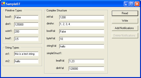

Task
Read and Write variables of any type with the help of the ReadAny and WriteAny methods.
ReadAny
In the event method btnRead_Click the method TcAdsClient.ReadAny is used to read a variable by handle:
public object ReadAny(int variableHandle, Type type)
public object ReadAny(int variableHandle, Type type, int[] args)
The type of the variable is passed to the method in the parameter type. In case the method was successfull, the read data will be returned as a object. The type of the object is equal to the type passed in the parameter type. Because some data types (arrays and strings) need additional information, an overload of the method ReadAny exists, that takes an additional parameter args. E.g., with strings one must pass an integer array of the length 1. Full list of supported types can be found in the documentation of the overloaded method.
Example:
A PLC variable of the type ARRAY[0..3] OF DINT should be read:
int hArr;
int[] arr;
hArr = adsClient.CreateVariableHandle(".arr");
arr = (int[]) adsClient.ReadAny(hArr, typeof(int[]), new int[] {4});
adsClient.DeleteVariableHandle(hArr);
WriteAny
In the event method btnWrite_Click the method TcAdsClient.WriteAny is used to write to a variable by handle:
public void WriteAny(int variableHandle, object value)
public void WriteAny(int variableHandle, object value, int[] args)
The parameter value is a reference to the object, that should be written to the PLC variable. Full list of supported types of the object value can be found in the documentation of the overloaded method.
Example:
A PLC variable of the type ARRAY[0..3] OF DINT should be written:
int hArr;
int[] arr = new int[]{1,2,3,4};
adsClient.WriteAny(hArr, arr);
Reading and writing of structures:
(not possible with the Compact Framework(CE) )
To be able to read or write PLC structures the memory layout of the structure or class in .NET must be the same as in the PLC. The layout of a structure or class can be specified with the attribute StructLayoutAttribute. The LayoutKind must be set to LayoutKind.Sequential and the pack must be set to 1. Therefore, the class SimpleStruct is defined as followed:
[StructLayout(LayoutKind.Sequential, Pack=1)]
public class SimpleStruct
public double lrealVal;
public int dintVal1;
If arrays, strings or boolean values are define the class, one must specify how these fields should be marshalled. This is accomplished with help of the MarshalAs attribute. Because arrays and strings do not have a fixed length in .NET, the property SizeConst is necessary for arrays and strings. It is not possible to marshal multidimensional arrays or arrays of structures with the :NET Framework 1.1. Multidimensional arrays in the PLC must be mapped to one dimensional arrays in .NET.
In the example the MarshalAsAttribute is used in the class ComplexStruct:
public class ComplexStruct
public short intVal;
//specifies how .NET should marshal the array
//SizeConst specifies the number of elements the array has.
[MarshalAs(UnmanagedType.ByValArray, SizeConst=4)]
public int[] dintArr = new int[4];
[MarshalAs(UnmanagedType.I1)]
public bool boolVal;
public byte byteVal;
//specifies how .NET should marshal the string
//SizeConst specifies the number of characters the string has.
//'(inclusive the terminating null ).
[MarshalAs(UnmanagedType.ByValTStr, SizeConst=6)]
public string stringVal = "";
public SimpleStruct simpleStruct1 =new SimpleStruct();
Register ADS notifications
In the event method btnAddNotifications_Click the method AddDeviceNotificationEx is used to register notifications for a PLC variable. If the value of a variable changes the event AdsNotificationEx is fired. The difference to the event AdsNotification, is that the value of the variable is stored in an object instead of in an AdsStream. Therefore, one must pass the type of the object to the method AddDeviceNotificationEx:
notificationHandles.Add(adsClient.AddDeviceNotificationEx("MAIN.dint1", AdsTransMode.OnChange, 100, 0, tbDint1, typeof(int)));
As user object the textbox that should display the value is passed. If the event is fired, the event method adsClient_AdsNotificationEx is called. For this the event must be registered in the Form_Load method.
adsClient.AdsNotificationEx+=new AdsNotificationExEventHandler(adsClient_AdsNotificationEx);

structure.dintArr[1], structure.dintArr[2], structure.dintArr[3]);
tbComplexStruct_boolVal.Text = structure.boolVal.ToString();
tbComplexStruct_ByteVal.Text = structure.byteVal.ToString();
tbComplexStruct_stringVal.Text = structure.stringVal;
tbComplexStruct_SimpleStruct1_lrealVal.Text = structure.simpleStruct1.lrealVal.ToString();
tbComplexStruct_SimpleStruct_dintVal.Text = structure.simpleStruct1.dintVal1.ToString();
private ComplexStruct GetStructFromControls()
ComplexStruct structure = new ComplexStruct();
String[] stringArr = tbComplexStruct_dintArr.Text.Split(new char[] {','});
structure.intVal = short.Parse(tbComplexStruct_IntVal.Text);
for(int i=0; i<stringArr.Length; i++)
structure.dintArr[i] = int.Parse(stringArr[i]);
structure.boolVal = Boolean.Parse(tbComplexStruct_boolVal.Text);
structure.byteVal = Byte.Parse(tbComplexStruct_ByteVal.Text);
structure.stringVal = tbComplexStruct_stringVal.Text;
structure.simpleStruct1.dintVal1 = int.Parse(tbComplexStruct_SimpleStruct_dintVal.Text);
structure.simpleStruct1.lrealVal = double.Parse(tbComplexStruct_SimpleStruct1_lrealVal.Text);
return structure;
// TwinCAT2 Pack = 1, TwinCAT3 Pack = 0
PLC program
TYPE TSimpleStruct :
STRUCT
lrealVal: LREAL := 1.23;
dintVal1: DINT := 120000;
END_STRUCT
END_TYPE
TYPE TComplexStruct :
STRUCT
intVal : INT:=1200;
dintArr: ARRAY[0..3] OF DINT:= 1,2,3,4;
boolVal: BOOL := FALSE;
byteVal: BYTE:=10;
stringVal : STRING(5) := 'hallo';
simpleStruct1: TSimpleStruct;
END_STRUCT
END_TYPE
PROGRAM MAIN
(*primitive Types*)
Bool1:BOOL := FALSE;
int1:INT := 30000;
dint1:DINT:=125000;
usint1:USINT:=200;
real1:REAL:= 1.2;
lreal1:LREAL:=3.5;
(*string Types*)
str1:STRING := 'this is a test string';
str2:STRING(5) := 'hallo';
(*struct Types*)
complexStruct1 : TComplexStruct;
