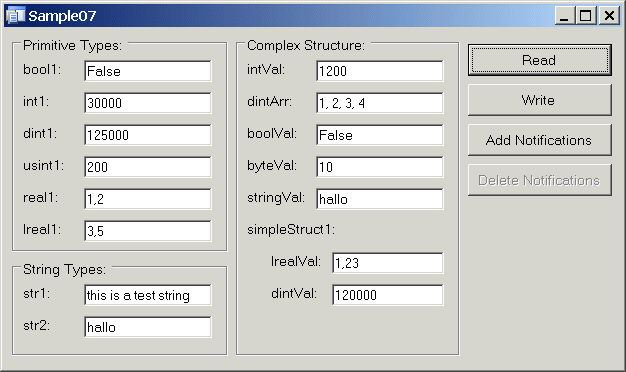

Task
Read and Write variables of any type with the help of the ReadAny and WriteAny methods.
ReadAny

Example:
A global PLC variable of the type ARRAY[0..3] OF DINT should be read:
var hArr : Integer;
var arr : Arrayof Integer;
hArr := adsClient.CreateVariableHandle(".arr");
arr := Arrayof Integer(adsClient.ReadAny(hArr, TypeOf(Arrayof Integer), [4]));
adsClient.DeleteVariableHandle(hArr);
WriteAny
In the event method btnWrite_Click the method TcAdsClient.WriteAny is used to write to a variable by handle:
TwinCAT.Ads.TcAdsClient.WriteAny(System.Int32, System.Object)
TwinCAT.Ads.TcAdsClient.WriteAny(System.Int32, System.Object, System.Int32[])
The parameter value is a reference to the object, that should be written to the PLC variable. Full list of supported types of the object value can be found in the documentation of the overloaded method.
Example:
A global PLC variable of the type ARRAY[0..3] OF DINT should be written:
var hArr : Integer;
var arr : Arrayof Integer := [1, 2, 3, 4];
adsClient.WriteAny(hArr, arr);

Register ADS notifcations
In the event method btnAddNotifications_Click the method AddDeviceNotificationEx is used to register notifications for a PLC variable. If the value of a variable changes the event AdsNotificationEx is fired. The difference to the event AdsNotification, is that the value of the variable is stored in an object instead of in an AdsStream. Therefore one has to pass the type of the object to the method AddDeviceNotificationEx:
notificationHandles.Add(adsClient.AddDeviceNotificationEx('MAIN.dint1', AdsTransMode.OnChange, 100, 0, tbDint1, TypeOf(Longint)));
As user object the textbox that should display the value is passed. If the event is fired, the event method adsClient_AdsNotificationEx is called. For this the event must be registered in the MainForm_Load method.
adsClient.AdsNotificationEx += adsClient_AdsNotificationEx;

method MainForm.btnRead_Click(sender: System.Object; e: System.EventArgs);
begin
try
// Read by handle, the second parameter specifies the type of the variable
tbBool1.Text := adsClient.ReadAny(hBool1, TypeOf(Boolean)).ToString();
tbInt1.Text := adsClient.ReadAny(hInt1, TypeOf(Smallint)).ToString();
tbDint1.Text := adsClient.ReadAny(hDint1, TypeOf(Longint)).ToString();
tbUsint1.Text := adsClient.ReadAny(hUsint1, TypeOf(Byte)).ToString();
tbReal1.Text := adsClient.ReadAny(hReal1, TypeOf(Single)).ToString();
tbLreal1.Text := adsClient.ReadAny(hLreal1, TypeOf(Double)).ToString();
// To read strings we have to pass the number of string characters
// specified in the PLC project(default 80). This value is passed as an int array.
tbStr1.Text := adsClient.ReadAny(hstr1, TypeOf(String), [80]).ToString();
tbStr2.Text := adsClient.ReadAny(hstr2, TypeOf(String), [5]).ToString();
FillStructControls(TComplexStruct(adsClient.ReadAny(hComplexStruct, TypeOf(TComplexStruct))));
except
on err: Exception do
MessageBox.Show(err.Message, err.Source)
end;
end;
method MainForm.btnWrite_Click(sender: System.Object; e: System.EventArgs);
begin
try
var structure := new TComplexStruct();
// Write by handle, the second parameter is the object to be written to the PLC variable
adsClient.WriteAny(hBool1, System.Boolean.Parse(tbBool1.Text));
adsClient.WriteAny(hInt1, System.Int16.Parse(tbInt1.Text));
adsClient.WriteAny(hDint1, System.Int32.Parse(tbDint1.Text));
adsClient.WriteAny(hUsint1, System.Byte.Parse(tbUsint1.Text));
adsClient.WriteAny(hReal1, System.Single.Parse(tbReal1.Text));
adsClient.WriteAny(hLreal1, System.Double.Parse(tbLreal1.Text));
// To write strings we have to pass the number of string characters
adsClient.WriteAny(hStr1, tbStr1.Text, [80]);
adsClient.WriteAny(hStr2, tbStr2.Text, [5]);
GetStructFromControls( var structure );
adsClient.WriteAny(hComplexStruct, structure) ;

method MainForm.adsClient_AdsNotificationEx(sender: Object; e: AdsNotificationExEventArgs);
begin
if( e.Value.GetType() = TypeOf(TComplexStruct))then
FillStructControls(TComplexStruct(e.Value))
else
System.Windows.Forms.TextBox(e.UserData).Text := e.Value.ToString();
end;
