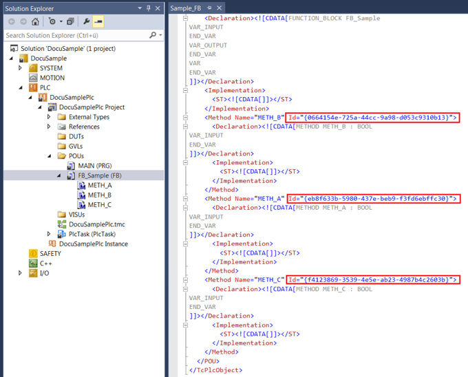

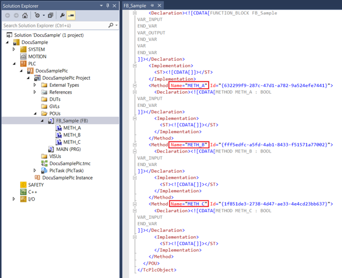

Sample
The sample illustrates the different storage sequence of the METH_A, METH_B and METH_C methods, depending on whether the Sort by name option is enabled or disabled. If the option is disabled (FALSE), the METH_B method is not in second place according to its name, but in first place according to its internal ID.
Sort by name = TRUE
Sort by name = FALSE
