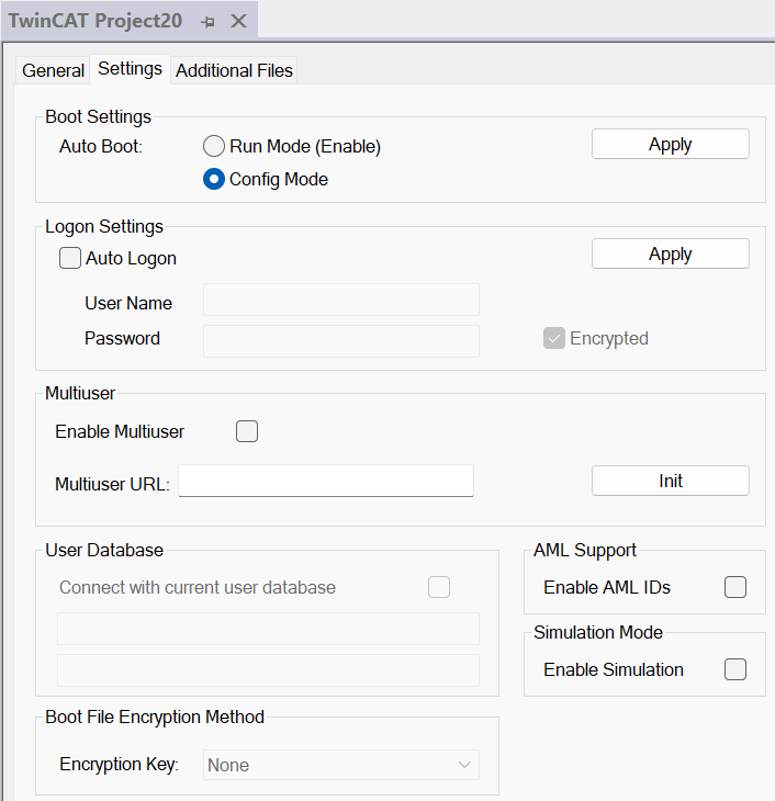

Settings tab
Settings tab 1:
Boot Settings
Auto Boot
  • Run Mode (Enable): TwinCAT starts in Run Mode as soon as the operating system is up and running. It does not require any users to be logged in.
  • Config Mode (default setting)
Auto Logon
If, in addition to the “Run Mode (Enable)” option, the “Auto Logon” option is also enabled, TwinCAT starts in Run Mode and the loaded and enabled boot projects are processed independently.
User Name
Password
User name and password
If you are working with an IPC, you can find more information on logging in to a system in the Windows 10 IoT Enterprise (LTSB/LTSC) documentation in the General information chapter.
Encrypted
Saves the “auto logon” password in encrypted form in the Windows Registry on the target system. (The password is stored as plain text if the checkbox is not selected.)
Apply
The settings are applied.
Multiuser
Enable Multiuser
Turns on the multiuser function for the System Manager.
Multiuser URL
Displays the multiuser URL for the Remote Repository or offers the possibility to change it.
Init
Initializes the multiuser function.
User Database
Connect with current user database
Connects the project with a user database.
AML Support
Enable AML IDs
Turns on the support of AML IDs. The AML IDs are stored in the project.
ADS Symbolic
UTF-8 Encoding
The ADS Symbolic uses UTF-8 encoding (this option is fixed from version 3.1.4026, so this option is omitted from this version).
Simulation Mode
Enable Simulation
Activates simulation mode for the entire project.
Boot File Encryption Method
Encryption Key
Encryption of the boot file
  • “None”
  • “User DB Key”
Target Archive
Project (.tszip)
Saves the TwinCAT 3 project only in the archive on the target system.
Solution (.tnzip)
Saves the entire solution in the archive on the target system.
