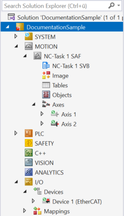

You can switch simulation mode on globally for the entire TwinCAT project (see Settings tab) or only apply it for individual axes or IO devices in the configuration. If simulation mode is activated globally, this is marked on the system node by a blue S on the icon. The TwinCAT objects concerned are highlighted with a green S on the icon (see image below).
Simulation mode 1:
The simulation mode can be set both in the axes area (see Settings chapter for the NC axis) and in the I/O area in the respective context menu.
