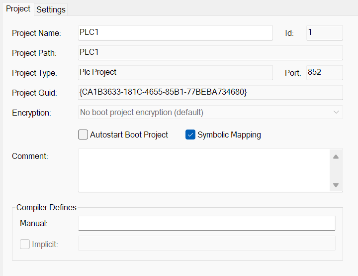

Project tab
Project tab 1:
Project name
Name of the PLC project
Id
ID of the PLC project
Project path
Path to the location where the PLC project is stored
Project type
Project type
Port
AMS port number of the runtime system
Project GUID
GUID of the PLC project
Encryption
Encryption of the boot project
  • No boot project encryption (default)
  • Encrypt boot project
Autostart boot project
Project tab 2: After the TwinCAT runtime environment has been started, the PLC boot project is automatically loaded and started.
The setting is transferred directly to the currently selected target system. The setting is not saved in the TwinCAT project.
This option corresponds to the Autostart Boot Project command in the context menu of the PLC project node in the Solution Explorer.
Symbol. Mapping
Project tab 3: Symbolic Mapping is enabled.
Force Multi Instance
Only available for stand-alone PLC projects:
Project tab 4: Option for logging in multiple instances of the PLC project enabled.
Comment
Comment box
Compiler definitions (available from TwinCAT 3.1 Build 4024)
Manual
Here you can define your own compiler definitions at System Manager level, which are passed on to the PLC project. The definitions are entered in the PLC project properties under the Compile category as system compiler definitions.
Implicit
Project tab 5: The names of the selected project variants as well as all groups to which the project variant belongs are automatically set as a compiler definition and passed on to the PLC project. The definitions are entered in the PLC project properties under the Compile category as system compiler definitions.
Note: In order to activate this checkbox, the Defines for the variant management must be enabled.
