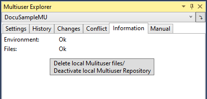

Information tab
Displays the status of the multiuser functionality and provides the option to disable this setting. This will delete the local repository.
Information tab 1:
Environment
Displays the state of the multiuser server:
OK: local and target repository found.
LocalNotExists: no local repository was found.
RemoteNotExists: no target repository was found.
Files
Shows the status of the files:
OK: local and target repository found, no newer project status on target repository.
LokalsbehindRemote: a newer version exists on the target repository.
Delete Multiuser files / Deactivate Multiuser
Deletes the local repository and deactivates multiuser functionality.
Information tab 2:
The Files status entry also displays OK if the local files status is newer than that in the repository. You can see which files have been changed in the Diff tab.
