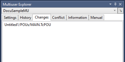

The Changes tab shows all files where changes have been made that have not yet been transferred to the target repository.
In the following image, exemplary changes have been made to the MAIN-POU (Program Organization Unit) of the Untiteld1 project.
Changes tab 1:
Changes tab 2:
