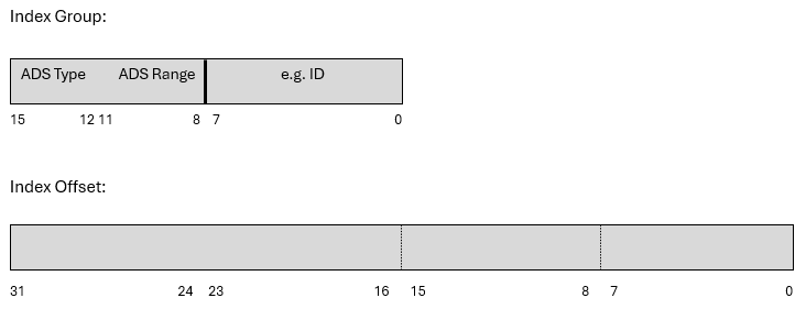

Specification of the NC
This documentation contains all TwinCAT 3 specific modifications and new features.
Index-Group | Description | Remarks | |
0x1000 | Optional! | ||
0x1100 | Optional! | ||
0x1200 | Optional! | ||
0x1300 | Ring-0-Manager: Cyclic process data | Not implemented! | |
0x2000 + ID |
0x2100 + ID |
0x2200 + ID |
0x2300 + ID |
0x3000 + ID | Optional! | ||
0x3100 + ID | Optional! | ||
0x3200 + ID | Optional! | ||
0x3300 + ID | Group with corresponding ID: cyclic process data | Not implemented! | |
0x4000 + ID |
0x4100 + ID |
0x4200 + ID |
0x4300 + ID |
0x5000 + ID | Optional! | ||
0x5100 + ID | Optional! | ||
0x5200 + ID | Optional! | ||
0x5300 + ID | Optional! | ||
0x6000 + ID | Optional! | ||
0x6100 + ID | Optional! | ||
0x6200 + ID | Optional! | ||
0x6300 + ID | Controller with corresponding ID: cyclic process data | Not implemented! | |
0x7000 + ID | Optional! | ||
0x7100 + ID | Optional! | ||
0x7200 + ID | Optional! | ||
0x7300 + ID | Optional! | ||
0x0A000 + ID | Tables (n x m) with corresponding ID: parameters | Maximum number of tables extended to 4095 (from TC3.1 B4021) | |
0x0A100 + ID | Tables (n x m) with corresponding ID: state |
0x0A200 + ID | Tables (n x m) with corresponding ID: functions |
0x0A300 + ID | Tables (n x m) with corresponding ID: cyclic process data | Not implemented! | |
0xF000 ... 0xFFFF | reserved area (TwinCAT system area) |
IndexGroup: | IndexOffset: |
0xF081 | 0x00000000 ... | ADSIGRP_SUMUP_WRITE |
0xF082 | 0x00000000 ... | ADSIGRP_SUMUP_READWRITE |
0xF084 | 0x00000000 ... | ADSIGRP_SUMUP_READ (READEX2) |
