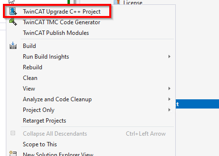

After installation under TwinCAT 3.1 Build 4026, a conversion is available on the C++ node for migration from the older projects ("driver projects"). This can be accessed via the context menu:
The migration generates a report as an HTML file that should be taken into account.
