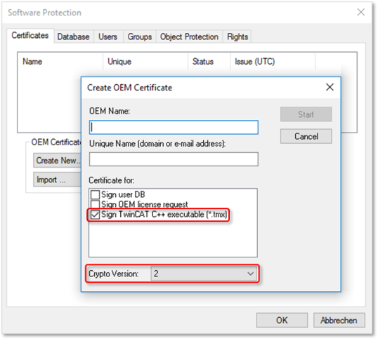

- 1. Call up the Software Protection configurator. To do this, select the menu item Software Protection in the main menu below the item TwinCAT:
- 2. In the window that opens, select the Certificates tab.
Click Create New....:
- 3. The Create OEM Certificate input window opens:
- 4. Enter the required data:
- Enter your company name in the OEM Name text field. The name must have a clear reference to your company or your business unit.
- Enter a Unique Name. The "OEM Unique Name" must be a unique name that uniquely identifies the owner of the certificate worldwide, preferably the URL of your company's website or your email address. The email address must be a company email address, i.e. it must be possible to assign it unambiguously to your company.
- Check the checkbox Sign TwinCAT C++ executables:
If you only want to sign TwinCAT driver software with this certificate, uncheck the other two checkboxes. (These are only used in the PLC area) - Make sure that Crypto version 2 (for the encrypted content of the certificate content) is set. (default setting)
- 5. Once you have entered the data, click Start and select a directory to save the file.
You can simply accept the suggested directory "c:\twincat\3.1\customconfig\certificates". You need the newly created file in this directory in order to be able to read out the "File Fingerprint" for this file in a subsequent step. - A dialog for selecting a password for the OEM Private Key opens.
- 6. Issue a password for the OEM Private Key.
Password security - Be sure to use a strong password for your certificate! Take suitable measures to protect your password so that it cannot fall into the wrong hands!
Password cannot be recovered if lost - Beckhoff cannot recover or reset your password. If you forget or lose the password for your certificate, you can no longer use it and have to request a new certificate. - 7. Confirm the password by entering it again and close the dialog with OK.
- The file is saved.
