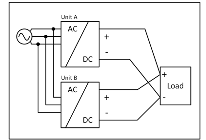

Parallel use to increase power
PS2031-2410-0000 power supplies can be connected in parallel to increase the output power. The output voltage of all power supplies must be set to the same value (±100mV) in "Single Use" mode and with the same load conditions on all devices, or the factory settings of the devices can be retained. After making adjustments, set the unit to "Parallel Use" mode to achieve load sharing. "Parallel Use" mode regulates the output voltage so that the voltage at no load is approx. 4% higher than at nominal load. See also Output chapter
The ambient temperature may not exceed +60°C.
If more than three devices are connected in parallel, a fuse or circuit breaker with a rated current of 15A or 16A is required at each output. Alternatively a diode can be used.
Restrictions: Keep a mounting distance of 15mm (left/right) between two power supplies and do not install the power supplies above each other. In parallel mode power supplies should only be used in the standard installation position (terminals on the underside of the device), not in other installation positions or under other conditions that require a reduction in the output current (e.g. installation altitude ...).
Remember that leakage current, electromagnetic interference, inrush current and harmonics increase when using multiple power supplies.
Parallel use to increase power 1:
Parallel connection
