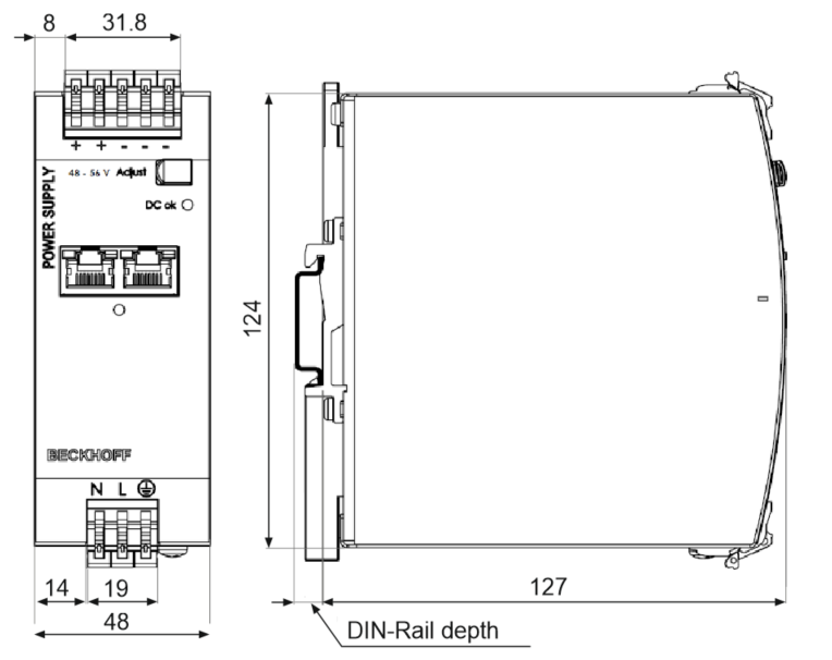

Dimensions and weight
Overall width
48 mm
Height
124 mm
Depth
127 mm
The height of the DIN rails must be added to the depth of the device to calculate the total installation depth required
Weight
830 g
DIN rail
Use 35 mm DIN rails according to EN 60715 or EN 50022 with a height of 7.5 or 15 mm.
Housing material
Body: Aluminum alloy
Cover: zinc-plated steel
Penetration protection
Small parts like screws, nuts, etc. with a diameter larger than 5 mm
Installation clearances
See chapter on Safety instructions and installation requirements
Dimensions and weight 1:
Front/side view PS2001-4810-1001
